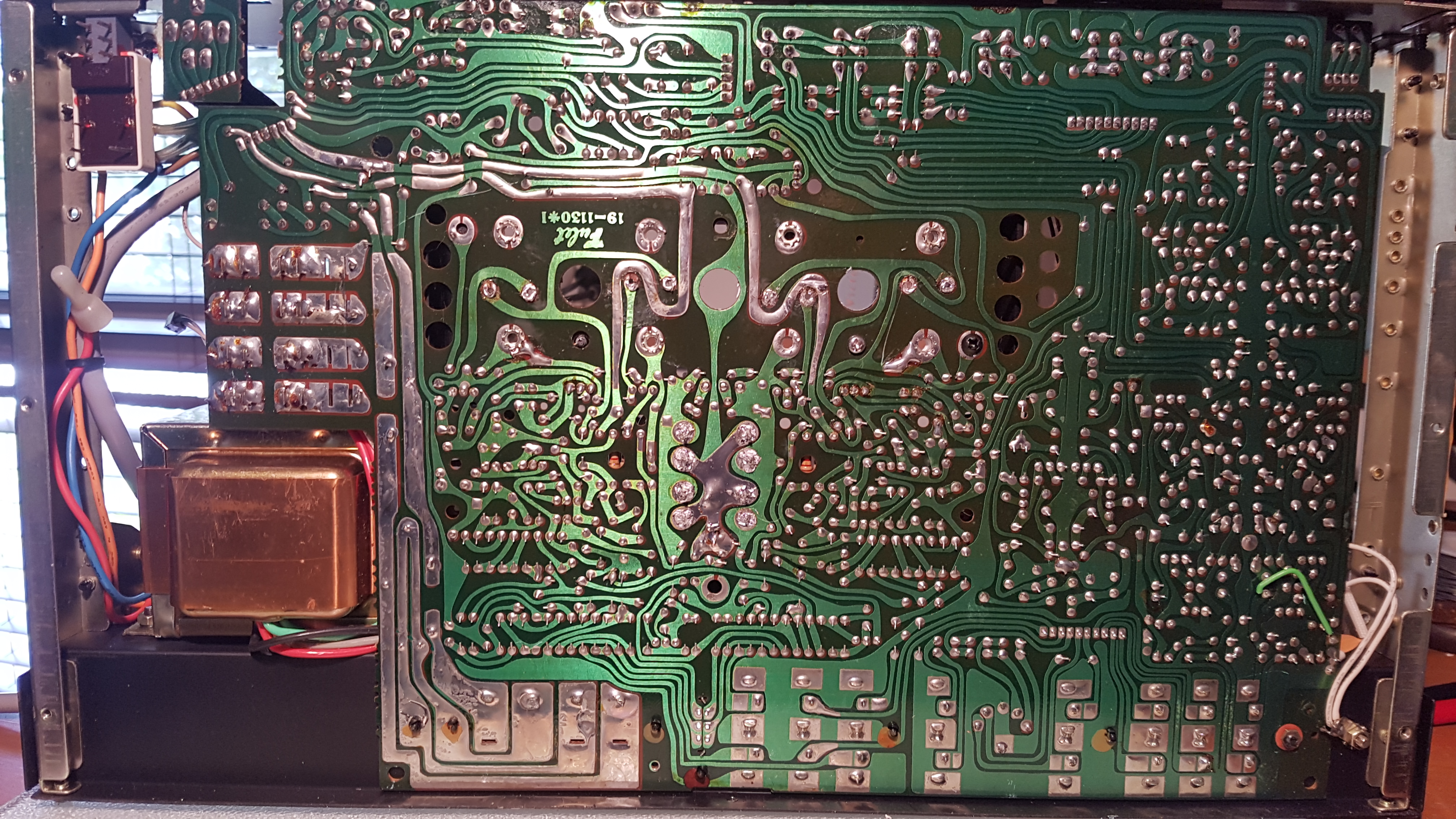

Hi, I've dug out a NAD 3020A Amp from my parents gathering dust corner and taken on the so far enjoyable learning process of attempting to diagnose and repair its issue(s).
It powers on, all inputs and outputs seem functional. But the volume - at maximum - is only a whisper. Left and Right sound balanced. And the 5 power lights (indicating 1-35W) don't illuminate - I presume this could simply be the globes or a deeper issue.
I replaced 4 main caps (2200uf 35v) because they had some visible corrosion/leaking on top. This resolved an idle hum which is reportedly common in this amp. The volume may now be marginally better but is still a whisper.
As a next step I removed and tested 4 main transistors (2N3055 and MJ2955). They seem to be open in the appropriate directions and showing ~300ohm resistance (30x10) as per pictured multimeter.
I see some brown glue around some caps which I've read may become corrosive. Otherwise all appear to be intact, albeit aged and potentially dried. I figured I'd seek advice and direction before tinkering with any of these.
To my eye the circuitry seems without abnormality. Except perhaps some orange/brown residue at some of the soldering points - see left hand side as pictured - these align with 4 fuses (intact).
Any assistance is much appreciated.

Hi there,
welcome to EP :)
That's not from the cap's but considering the apparent age of the unit, replacing them isnt a bad idea :)
In fact, I would be suspicious of all electrolytic cap's
Taking out one of the glued caps and looking underneath it would con\firm if there has been any corrosion :)
probably not ( but maybe)
As said, replacing them all would be good, they have all probably dried out inside to some extent
That's just a bit of solder flux :)

That old meter may or may not be capable of providing enough bias to test transistors.
Usually when they have a x1 range but none on this antique.
Could verify by testing say an 1N4004 diode or similar.
What are you using as an input..?
What sort of voltage levels are you getting on the rectifier output and on the adjacent caps ..?
Rectifier is the rectangular part centre of where you removed the output transistors.photo #5
Caps for the dc output are the 4 adjacent I'd imagine.

Thanks davenn, very helpful. I notice in the service manual parts list CER, MY, and ELEC Caps. Assuming these correlate to Ceramic, Mylar, and Electrolytic. Assuming age related deterioration would your recommendation be to replace only the Electrolytic Caps?
Bluejets, thanks for the illuminating comment regarding my old meter. I'm struggling to find good instructions on the tests you've mentioned. Could you please explain how I would do so?

What’s that three legged component next to C637?. Just above the transformer in your last photo.
It looks rather malformed.
As previously said, ALL the electrolytics should be replaced as a matter of course.
During the 80s, many companies used glue for components which did indeed prove to turn conductive. This should also be carefully removed/scraped away. Then try the amp.
Use a good contact cleaner on all switches and pots too.
Martin
It's a 2SD669. I think the light casting a shadow gives the illusion of it being malformed. Unless you mean the degree to which it leans?
Thanks for clarifying replacing the electrolytics. I'll do that and a clean as directed.

Just finished replacing all bar 4 elec caps, awaiting delivery of the these final few. Warmed it up to test and it's working and sounding glorious. I found some oxidation on the legs of some of the caps I removed so perhaps that and/or their age was the issue.
Thank you all for your help.
Martaine2005
May 12, 2015
5,318
May 12, 2015
5,318
The oxidation was probably due to age but electrolytic caps dry out over time and can become ‘resistors’ or ‘short circuits’ causing all sorts of problems.
Glad it’s working now. Don’t forget to clean all switches and potentiometers too.
