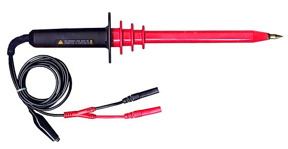

I've been considering getting one of these:
I plan on putting it in a glass case with the caption "If you need this then reconsider what you're doing"
