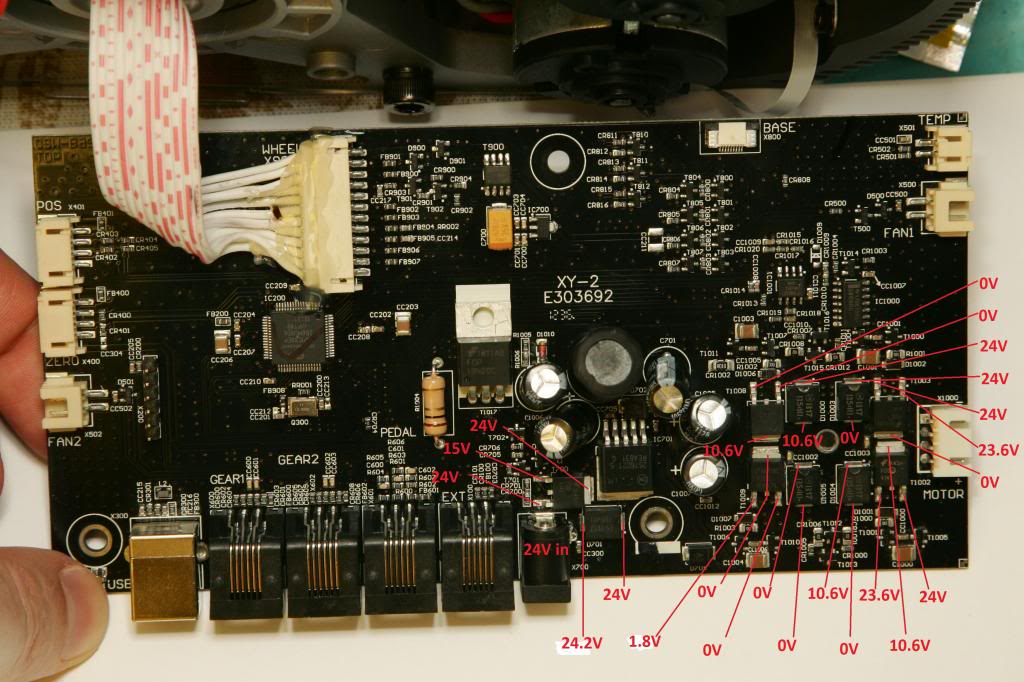

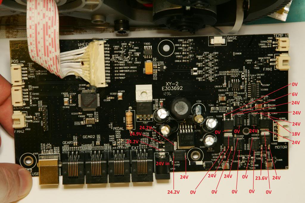

Hi all, I have a computer FFB steering wheel that was recently damaged by an overvoltage condition. The components are rated for 40V and I accidentally fired it up with 52V. Now, the motor drive for one direction isn't working. I thought I had blown one of the driver MOSFETs (Fairchild FDD4141 and FDD8447L) so I grabbed some from Mouser and replaced the ones I thought were bad, to no avail. I then replaced all of the MOSFETs and still one direction doesn't work. The circuit is using 540 Schottkys but when I checked them they all seemed to give continuity in one direction and blocked the other, so I think they're OK. I don't know where to start, can anyone suggest some steps to take in diagnosing this? I can see no visible damage anywhere on the board or components after careful inspection under a loupe.

A computer FFB steering wheel is a steering wheel used in computer simulation racing that has Force Feedback. The 540 Schottkys I believe are barrier diodes, I'm not sure what the proper name is, you can see them in the photos of the bridge below. There is no service manual or schematic available, and the user manual is a joke. I am somewhat new to the electronics world but I am hoping you guys can help me out with this, I know the basics and I learn fast. I can do hot air rework etc. I have already replaced all the MOSFETs on this board.
Here are the voltages I found by checking so far, it looks like everything is switching correctly, right? But voltage is not right. So would the controller be the next item to check? I'm having a hard time following the traces. The first pic below is the wheel trying to turn clockwise but nothing happens. The second pic it's trying to turn counter-clockwise (I have unplugged the motors so I could check the voltages; when plugged in they function correctly in the CCW direction). (Pictures moved to below).

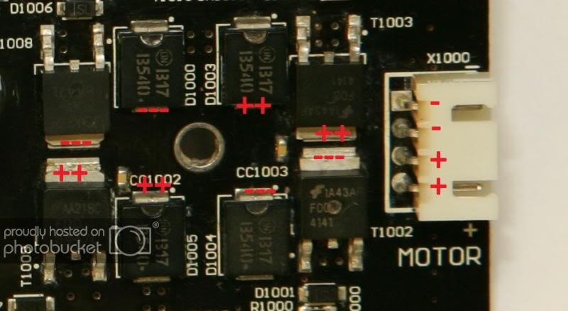

Here's a crop of the bridge showing the continuity of the motor pins to the MOSFETs and diodes:
On the larger photos: let's see if this is any better:
Attempting Clockwise rotation (dead motors):
CW_Lg.jpg:original
Attempting Counter-clockwise rotation (motors work):
CCW_Lg.jpg:original

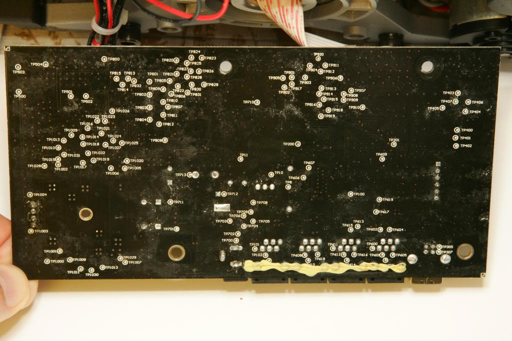

Back Side:
Back_Lg.jpg:original

Can you tell if a high current flows when you are attempting to rotate the motor in the direction it doesn't go?
Looking at the 2 diodes D1000 and D1003, when the motor is turning, one diode reads 0V and the other 24V. This indicates the appropriate mosfets are turned on.
When attempting to turn the motor in the other direction, the voltages should be 24 and 0, but you get 10.6 and 0.
If there is a heavy current flow, this would be indicative of something shorted.
However I think it is more likely that one of the mosfets isn't being turned on properly.
When the motor is working, the top 2 mosfets are on. It appears in both cases that Vgs is 6V
In the case when the motor isn't working, the bottom 2 mosfets should be on.
We're seeing only 1.8V and 0.4V Vgs. I suspect that there's a driver in common for the bottom pair of mosfets and it is damaged.
See if you can trace where the gate of these mosfets (T1002 and T1009) are connected to (they are isolated from each other, but it would not be unusual for them to go to the same driver chip). There may be a low value series resistor too.
Actually I note a diode and a resistor near each mosfet. These are possibly connected in parallel and connected between the gate and the driver.
I also note that there is not a pair of similar devices close by the mosfets. The driver may be the 8 pin or the 14 pin device.
The 8 pin device appears to be an LM358 -- I'd not suspect that at the moment.
The 14 pin chip is a quad NAND gate -- probably not that either.
That really only leaves the 4 transistors just below it. These *may* be used to switch the mosfets, and *may* be worth checking. -- I'd have a quick look at the voltages on their base, emitter, and collectors in the two cases and see if there's any clues there.
Maybe you can determine if they connect to the gates of the mosfets.
