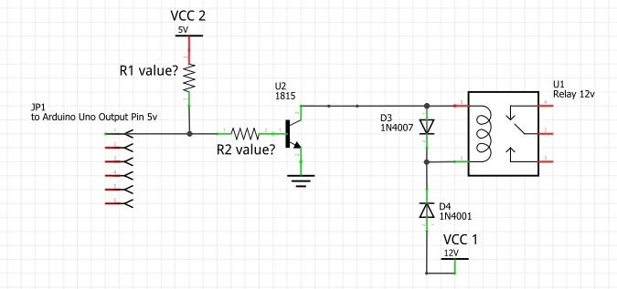

I have this diagram, now the arduino uno output pin (microcontroller) is 5 volts, what is the value of resistor R1 and R2 ?

R1 is not required at all. The arduino can pull-up or pull-down the output.
The value of R2 depends on the current required by the relais and the gain offered by the transistor.
Assuming a conservative DC gain of the transistor of 10 (for full saturation), the base current needs to be 1/20* Irelay. From the min output voltage of the arduino and the base-emiter voltage drop of U2 you can calculate
R = (Voutmin-Vbe)/Ibase
Of course you could replace the bipolar transistor by a logic level MOSFET (e.g. BSS138) then you will need no static gate drive current at all. A 100 Ω resistor for limiting the inrush current to the MOSFETs gate would be sufficient in that case.

Why are D3 and D4 different? I would keep a stock of 1N2007 for all situations such as this.
Because some people think the flyback resistor needs to handle high voltage spikes. In reality, it does not, it only sees the same voltage as is applied to the relay coil.

Query . . . . . Where is the flyback resistor on that schematic ?

1) The voltage spike is multiple times higher only if not limited.
2) When flyback sets in, the diode is forward biased, therefore limniting the flyback voltage to ~ 0.7 V.
The misconception here is, iI think, confusing the flyback voltage with the diode's reverse voltage. The reverse voltage the diode experiences is the operating voltage of the relay coil, 12 V in this circuit.

When the relay is energised, it will have 12V across it and a current determined by the resistance. When the relay is turned off this current has to go somewhere until the inductive energy is dissipated, the diode will do this.
If the diode is replaced by a resistor equal in resistance to the relay, initially it will have 12V across it so the switch will see 24V at turn off. The relay will open faster than when a diode is used. You could use a resistor (or Zener) and diode in series as long as the switch can withstand the voltage.

The flyback voltage only rises to the voltage that allows the current in the inductor to continue flowing. The flyback diode is forward biased and thus only about 0.6 to 1V, depending on the current and the diode are required to keep the current flowing, and it goes no higher than that.
The diode is reverse biased only when power is supplied to the relay coil, so it’s reverse voltage needs only to be higher than the voltage driving the relay coil.
As far as the voltage of the flyback pulse, maybe it would be easier to understand if there was resistor in place of the diode.
If the coil is carrying 1A and suddenly the voltage driving it is cut off we can calculate the voltage flyback voltage. If the resistance is 100 Ohm, the voltage will be 100V. Raise it to 1000 Ohms and you get 1000V!

No, it never becomes a high voltage. The voltage only rises to the level that will allow the current flow, in the case of the diode, that is between about 0.6 and 1V. I don't consider that a high voltage.
It if was otherwise, what voltage would it rise to, 100V 1000V, 100 MV?
If you scoped it you would not see any high voltage.

Get rid of R1; farkle with R2 until U2 reliably saturates; remove D4 and replace it with a piece of wire, connecting VCC 1 = +12 V DC to cathode of D3 and one end of the relay coil.

The 1N4000x diodes are not particularly fast with reverse recovery times in the µs range (link). Therefore your assumption is not completely wrong. There will be a rising voltage across the diode until conduction sets in. A scope measurement as suggested by Hop could sort this out.
However, A much better and faster solution here is using a fast switching diode, e.g. a 1N4148. It will operate perfectly across a 12 V relay coil and with reverse recovery times in the ns range you will observe almost no voltage spike.

2SC1815 comes in four different hFE grades 70 -O, 120 -Y, 200 -GR, 350 -BL.
It's max Ic is 150mA and for saturation 10-15mA base drive would be great - so R2 = (4.75V-0.9V/10mA) is around 385Ω.
R1 is only needed if the relay must be on if the Arduino is dead, stuck in reset. But if the Arduino gets hung in a loop with the relay output off, R1 is useless. I would leave it out.
D4 is only to deal with -ve voltage transients like you would see in a car. They are around -250 to -400V so D4 should be 1N4005 or higher, or you can swap D3 and D4. D3 can be smaller a 1N4148.
