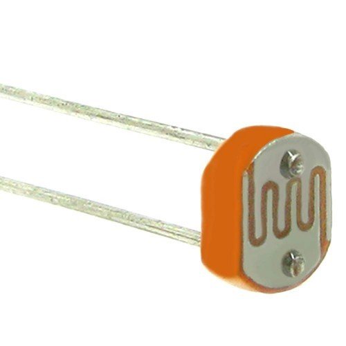

Hello there.
I found a circuit guide to make a LDR night light. I have got a question :
the 10K resistor reduces the brightness of LED quite remarkable. I tested with lower resistors , even less than 1K resistors. Brightness increases as resistor lowers , but the problem is that it also reduces sensitivity of LDR. I mean If I use a 1K resistor , for instance , then the LDR needs too much brightness of light to turn the LED off.
What to do ?
Thanks
* I don't use a resistor between LED and power source (in the picture which is marked as "If needed")
* I use 7-millimeter LDR . All other specifications are similar to the photo of circuit I attached

Select a more sensitive LDR, they are all different. Mine have sensitivities of 10 to 1.
Select a transistor with a higher hFE at high currents like a 2N4401 or a darlington transistor then the base resistor value can be higher.
Use a resistor in series with the LEDs to prevent them from burning out.

You will get more even illumination and longer LED life if you have one current limiting resistor for *each* LED. Also, you are not going to get very "snappy" response from a single transistor circuit with no hysteresis. Consider two transistors, with at least one of them being a 2N7000 or 7002.
