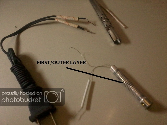

I got another question. Well I have this cheap soldering iron that I got a year ago which is now defective. So I opened it up and I found a nichrome wire. So I was wondering on how can this soldering iron have a fixed temperature or wattage without any resistor or transformer just like you said and be plugged in directly? Maybe I can apply this method into my acrylic bender. That soldering iron's specs is 40W. 220/240V

It has much finer wire that the bender. It has higher resistance, cannot pass as much current at line voltage levels, and therefore does not get as hot. It actually doesn't hold a constant temperature. I don't think that it would get hot enough for a bender. But, you could try it and see.

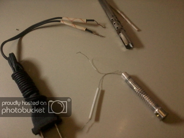

I found out that there are two layers of wires wrapped around a heat insulator in every layer. After I removed the first wire, I found another wire but it's much thinner than the first one. Both wires are connected to each other.
Which of the two wires produces heat?

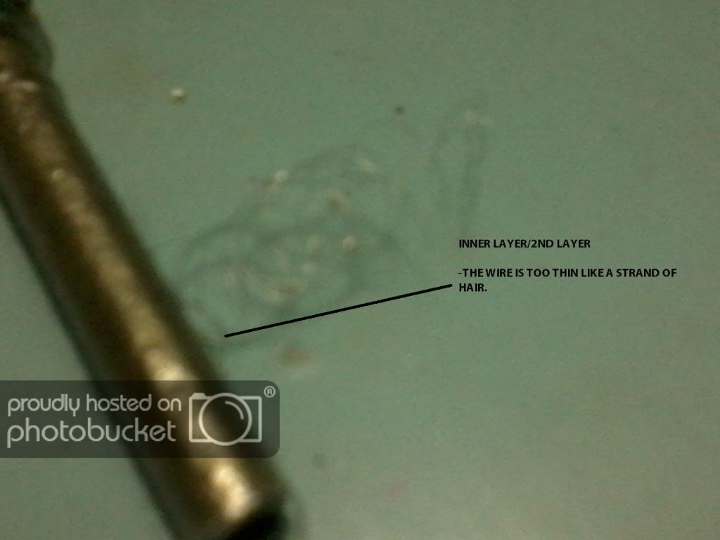

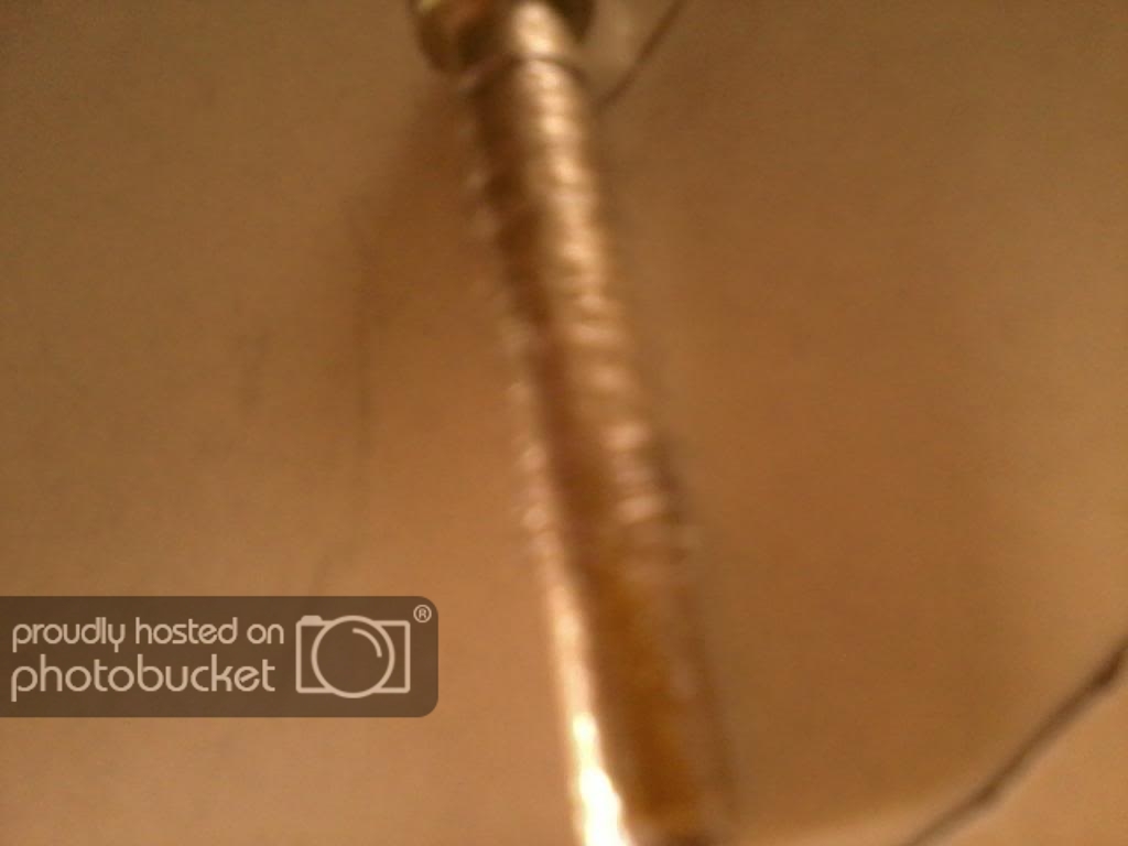

Sorry Dave. My camera is crappy and the wire is too thin like a strand of hair. I'll provide another photo.
This is the first layer. See that wire? That wire is connected to the second wire in the second layer. The wire in the first layer is thicker than the 2nd one.
The 1st layer/wire has been removed. This is the 2nd layer. That curly string is the 2nd wire. It's too thin.
