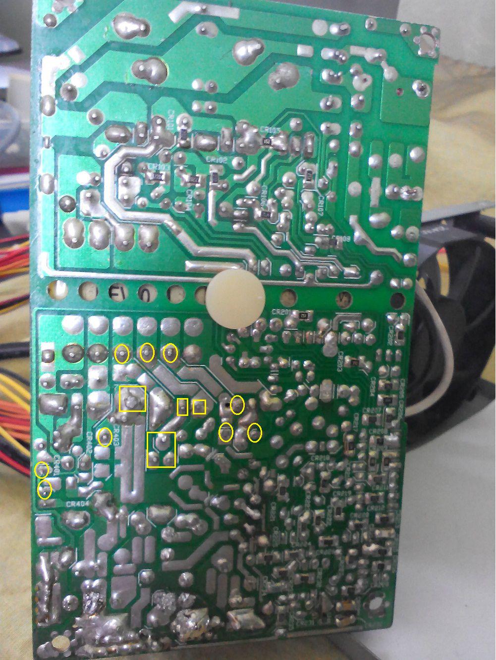

Hi all,
I got this piece of dead china made switching power supply AVF brand labelled as 350w from a friend who previouly used on an old pc. When i opened the case nothing seemed burned and no sign of bulged caps. To prevent further damage, i connect a 100 watt light bulb(our country main supply of AC is 220 V) to replace the 5A glass fuse. I also use a piece wire to short the green ps on to black ground on the pc power connector.
When i switch on the mains, the fan not spinning nor the light bulb on. How do i go on further test to diagnose which component is at fault? On hand i have a digital multimeter,digital capacitor meter,and have a 40watt soldering iron.
Any help and suggesstion to repair this power supply is very much appreciated.

Sir mikey5791
I HEAVILY suspect . . . .
With no parts blown and fuse intact. . . . .
Get your self a BRIGT light or go outdoors for sunlight along with
a STROOOOOOOOONG magnifier and confirm that these wires/terminals
are not FLOATING within their solder joints.
Plus you need to inspect about another 100 or so connection / joints in the
high current paths.(WIDE foil)
Also, you can only be POSITIVE on some extremely BADLY oxidized situations,
until you pull a component and scrape its leads clean down to the bare copper and
then liberally rosin flux and then heavily re-tin and reinstall the unit.
Pee Ess . . . . .BTW
A wimpy little 40 watter is being very borderline inadequate on most of these joints thermal mass
that will be involved in trying to get up to proper reliable solder re flow heat levels.

Hi Sir 73's de Edd,
I am a bit flattered by your formal salutation but later after seeing your country icon I can understand. Thank you for your suggestions and quick reply.
May I confirm with your statement saying "Get your self a BRIGT light or go outdoors for sunlight along with a STROOOOOOOOONG magnifier and confirm that these wires/terminals are not FLOATING within their solder joints. Is FLOATING meaning a break or crack in the solder pad, wire/terminals not fully in contact to the PCB pad?
First, I will relook at those 15 marked up solder points as you suggested to pull the component (unsolder),then clean it to bare copper, retin and then reinstall. I will do the suggested and report back soonest.
Have a fine day then.

Sir Michael . . . . . .
Indeed your perceptions are being correct . . . . .
May I confirm with your statement saying :
"Get your self a "BRIGHT" light or go outdoors for sunlight along with a STROOOOOOOOONG magnifier and confirm that these wires/terminals are not FLOATING within their solder joints.
Exactly . . . . some times you can find a component that is so loose, and has solder that has eroded away so bad, that you can grasp it from one side of the board and watch it move on the other solder side of the board.
Sometimes the contact area has decreased so much that an arcing has occurred and those are the ones in such bad shape that they sometimes require removal to get them tinned and able to be soldered in to get good connectivity again. OR a new part could be installed.
The reason I suggested a magnifier is that is so apparent that a portion of a connection is not having good solder coverage.
The most of those joints will need a drop of rosin flux and then a HOT soldering iron put to them until you see a thorough flowing of solder and the making of a solid connection . Some will need some solder added.
I merely pointed the joints that SEEMED to be floating or POSSIBLY floating, your sharp eye will have to confirm for sure, as there must actually be a 100 connections on that secondary area fed from the switch mode power transformer just above.
ALso your POWER FET circuitry that drives the primary of the transformer is being up and across the transformer from my top 3 YELLOW ovals that I have marked up.
The left connection of /or/ near near CR103 also looks suspect, CR101 area also. Plus there is also more HEAVY foil circuitry all over that half of the board also.
You may just need to find ONE connection for that PS to be working again, but finding other marginal ones NOW, will be one more failure that will not occur TOMORROW.

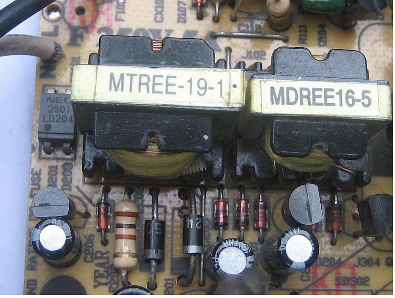

With my limited knowledge, how do I test if the 16 pin IC KA7500B (Fairchild SMPS Controller) is good?
Yesterday out of curiousity, I tested two black diodes (next to a 100ohm resistor) below that small transformer "MTREE-19-1" and found 1 diode labelled CT(first row) SB240(second row) shorted. I used diode range and it read 001 at one end and swap probes and get 001 the other way. Is this a schottky diode 40 Volt 2.0A type? The nearest diode stock that i have is a LT116(first row)2A05(second row) which gives a peak repititive reverse voltage of 600V and average rectified output current of 2.0A. Can I use this to replace the shorted CT SB240 ?
I have not resolder the six removed caps due to waiting replacement of this shorted diode. Once this diode is replaced and the six caps soldered on pcb and put a load(maybe a 12V DC fan will do ?) and the series bulb still connected, is it time to power up to see if the PS will work?
Appreciate all the feedback and suggested points on the troubleshoot.
Thank you all.
dorke
Jun 20, 2015
2,342
Jun 20, 2015
2,342
You are correct about the SB240 a "schottky diode 40 Volt 2.0A".
You need a schottky diode for replacement.
Don't know what LT116 is.
The 2A05 (si diode)is not good for replacement because:
1. Vf to high
2. si, too slow
73's de Edd

Yesterday out of curiosity, I tested two black diodes (next to a 100ohm resistor) below that small
