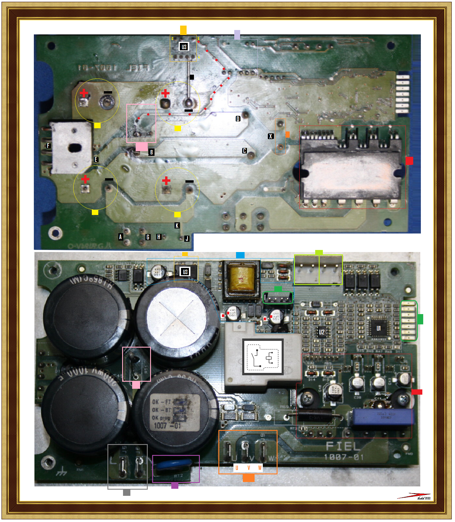

Hi everyone . I recently purchased a tire changing machine that came with an engine that was not working. It is an elprom engine and the control board is a Fiel 1007-01 .I took the cover off the control board and discovered that one of the 4 large capacitors had burned through it's solder contacts on board.Could see black soot that was on the metal board underneath it .There was a thermistor beside it that had a small piece out of the side of it .I replaced both but still board is not working.Need some help to test /diagnose what could be wrong with this .These boards are impossible to find so replacing it seems unlikely or very expensive.It's made in France and the motor is made in Italy.From what i gather the control board input is 120 volts then converts to DC then back to 220 volts ac to the motor. This board is connected to switches that controls the 2 speeds and reverse for the motor.I am only a beginner but have a multimeter and can solder well.Any help would be great

If you want to do some basic test/checks then you'll need a 'decent' multimeter. Do you have one?
Assuming you do, we can start at 'first principles' and check the rectifier on the left-hand edge of the board.

I checked online video how to test rectifier . I think it is ok. tested .456 on each leg and when pos/neg reversed tested OL

Coloseup focused pic of bottom of board. Any signs of heat near a
component ? Or leakage ? Any caps bulging ?

The other area of 'concern' would be the main switching transistors that are likely under that other large heatsink. It looks very much like a manufacturer-specific device too which means that, assuming you can identify it (connections/datasheet) and make the relevant tests, you're unlikely to find a replacement part should it be dud.
What you're going to have to do is remove that large device first off....... else the method would be to reconnect the board and start measuring live voltages around it - which meas connecting it up on a workbench and flipping it top/bottom whilst taking those measurements.
Since this type of board usually (but not always) fails at the input side (mains rectification/smoothing/switching) or the output side (more switching and regulation) and not very often the bits in between then there is no real choice given the lack of schematic but to follow the 'usual suspects'.....

Sir waybel . . . . ( Whut's a waybel ? )
I would Hold Off on that . . . . or even considering that . . .until initially seeing if any of the BASIC board requirements are initially being met.
More is to follow . . . as it is now being composed . . . . graphically
But, to fullee gits my munneys wurth on this 'a here posting now . . . .
Initially feed back the alpha / numbering on top of the boards low voltage power supply sourcing, which is using the 8 pin IC, (purposefully missing ts #5 pin ) and is physically located at boards edge, just above your BIG BLACK NICHICON replacement E-cap.
Its power derivation companion is being the top center located mini power transformer .
For my curiosity, but of minimal import, would also be the other 8 pin mini flat pack just to the left of that IC.
I suspect the adjunct black 4 pin rectangular optical isolator to be of the '817 family . . . along with a set of an additional 3 across the board tops right end..

Sir waybel . . . . .
Don't expect textual or intellectual perfection on this context as it started out as initially being a private conversation
Don't I get any response to my #14 posting . . .or . . . are you still in the process of collecting that info ?
In the interim, I have developed the additional need of even more info.
About the units two thermistors . . . .RT1 and RT2 . . . . . .
In this units particular application / utilization . . . . . .What do YOU perceive / think that their functional purposes are being for ?
On the one you replaced, how did you go about knowing what to use to replace it ?
What was the ambient room temperature resistance of the original unit, as well as that same info for your replacement unit.
FAILURE ANALYSIS . . .
Do you know what manufacturing fallacy, that in time, led to your having to replace that sole 1000ufd / 200vdc E-cap ?
You tell me you have 120 V usage . . . got it .
I see two cables going inside the unit, of which, the very dead center one is being a tri- wire HOT AC line, a NEUTRAL AC line and an equipment ground wire.
Understood . . . . and they go into the respective push on connectors at the bottom left corner of the board . . . . . with you being SURE of their plug in positions . . . unless they are being size keyed.
The green ground gets a screw ring terminal.
Agreed ?
Now for the real nitty- gritty . . . the off center cable entry and those two black wire pairs . . . I can see them going inside to the slightly off center rear of the board and plugging into a 4 pin white Molex connector.
I'm expecting the wire gauge thickness, helping in holding the two separate plugs in alignment so that they don't get transposed / reversed.
Since you have the whole unit . . . to confirm with your inspection. I am expecting one set of wires to activate power activation of the REAL power aspect of the unit which will be the two HEFTY paralleled capacitor banks within the unit . . . one pair on top and one pair on bottom.
They are being AC power switched on, by the off center located, white ICE CUBE power relay . ( I'm Not expecting it to be faulted)
Two polarities of significant power exit from those cap banks ( + & - @ 160-170 VDC ( subject to motor loading pull down) @ 3 amps . . .BABYCAKES ! those power pairs then travel to the right on the board to the . . .HUGE hybrid power driving IC.
Then that power units input is waiting for its drive from the top right corners uP and its companion IC to the left as well as the ladders of surface mount resistors used to create a variable frequency capable . . . . . 3 phase related waveform . . . those 3 separate waveforms then go into the 3 canned 10 ufd caps as being drive to the BEHEMOTH hybrid POWER I.C.
That power units input is waiting for its drive from the top right corners uP and its companion IC to the left as well as the ladders of surface mount resistors to create a variable frequency capable . . . . . 3 phase related waveform . . . those 3 separate wave forms then go into the 3 canned 10 ufd caps (silver tops) as being drive to the BEHEMOTH hybrid I.C.
They exit that POWER IC as high energy drive for your brushless permanent magnet based motor and take 3 wide foil paths across the front of the board to the U V W marked terminals and connect to the motors 3 WYE wires.
Look down inside the casting hole to see your motors casing manufacturung date . . . I can see it but its not letting me read its fine detail.
I see that your motor controller board is being no older than 2014.
Confirm:
That one black wire set
is for signalling of need of full power actuation of the motor ( with its control boards low voltage power supply being in standby / hiccup mode from the instant that this unit was connected to AC power . . . 24 hrs a day.)
That the other black wire set is associated / connected to a speed pot for the feeding a variable resistance back to the units uP area for interpreting in doing a digital interfacing in the creation of a coincidental digital waveform.
Now if you will just feed back to me . . . . .we can start an actual circuit sleuthing.
