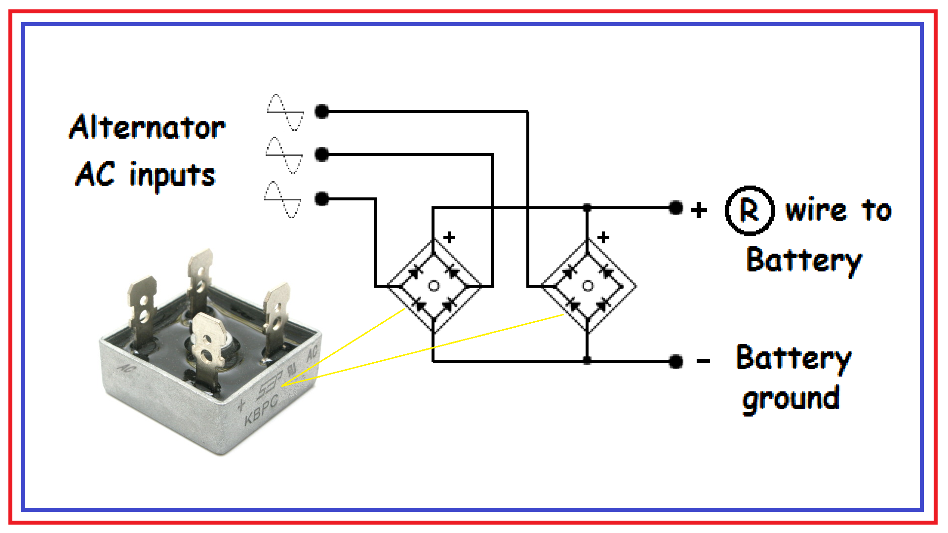

i'm replacing a regulator rectifier on an old harley dirtbike. the part is discontinued. i'm trying to figure out the schematic and what i can replace it with as far as a new rectifier from something else.

i understand the way it converts ac to dc with the flipping of the waves and regulated with a capacitor. i just don't understand if i can just use a single wave rectifier and just ignore the wire that goes through the switch. or does the wire that's common on the alternator need to be grounded or what.

Back to the rectifier assembly only . . . .referring to the schema below:
If you have to make up a rectifier unit from scratch consider some of these Full Wave Rectifier blocks in metal cases, used for further heat sinking contact area.
If you trace the + battery connection to the pair of blocks you will see ONLY a diode cathode being encountered, which means NO flow from the battery to the alternator windings.
This is a strictly one way power flow . . .from the alternator into the battery.
We have no idea on the old rectifier construction, without dissection and reverse engineering evaluation, but they seemed to want to disconnect from the alternator.
It you have a bad old rectifier unit needing replacement . . . you might just try this possibility out . . . . they offer these FWB blocks voltage rated on up to 1000 volts . . . God forbid . . . .
and you pick their current rating at . .5-10-25-50 amps ?

Looking at the post #1 pic, is the alternator 2-phase rather than 3-phase? I'm reading it this way :-
The G wire goes to the field winding (shown in the external box), whose current is controlled by module 7 which is not only an ignition module but also a voltage regulator.
There are 2 phase windings, connected by BN wires to the rectifier module.
There is a dedicated ignition winding connected by the R wire to module 7.

www.sunnymeadcycles.com/files/H-D_Aermacchi_wiring.pdf
i don't know if this will help. the bike i have is a 2 stroke 1974
i have a universal single phase regulator on its way. it has 2 ac inputs, power out, and ground wires.
i just don't know what to do about the yellow wire from the alternator.
o and the bike runs fine without the charging system connected.

I was wondering what Colin was referring to, as that is being a proper rectifier circuit for common 3 phase alternators.
But he came back with no supplication.
Then I look back to where I had initially referred on my small laptop, and now I see that you have a two phase alternator.
So your O wire would just be disconnecting the alternator common from the Rectifier block in SWITCH off position and a second section of the switch disables the sensor feed to the electronic ignition module.
