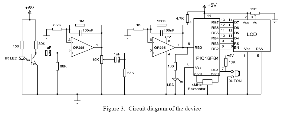

Hi guys.
I am a final year student of Beng Electrical and Electronic.I am currently doing a project titled "heart rate measurement using fingertip" by Dogan Ibrahim and Kadri Buruncuk @ http://www.emo.org.tr/ekler/a568a2aa8c19a31_ek.pdf and i have modified the circuit and the programming based on my ideas.Therefore, I would like to ask your help in order to check whether there is any problem with my circuit diagram and also with my programming code since i have modified the project on my own.In the hardware side, it works fine but i could not simulate it on the proteus and i suspect that there might be a problem on the circuit part that i may have overlooked.If there is no problems,then only i can do the etching process.
The original circuit by Dogan Ibrahim and Kadri Buruncuk.
My modified circuit.
I added the buzzer on the pin 18 and the "abnormalities" led on the pin 17 of the pic16f784a.In addition,I also added the "on" indicator led with the +9V and the "reset push button" through the pin 4 of the pic16f84a.The programming also have been done according to the changes desired.
The original operation of the project...

The rest of the information are attached together with this thread.
[url]http://www.mediafire.com/?v1suh1fzi19tqyu[/URL]
Note: For the proteus simulation, i have to use the opto-coupler because i could not find the IR diodes.
