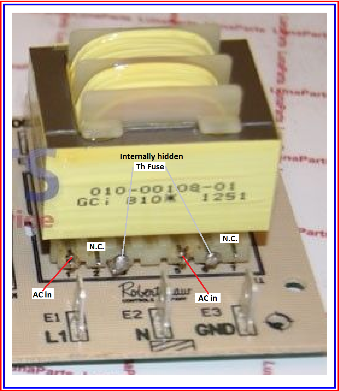

I am trying to replace this Basler electric transformer that I got off of my oven control board, it seemed to have burned out when I took it off the board.
I am typically fairly good at finding related information when it comes to google, but for some reason I can't find anything generic equivalent transformer.
Was wondering if anyone has any advise on how to find a replacement transformer (a new relay board runs about ~160), I am hoping to repair my oven under $20...

Trying to repair my oven relay board. It burned out this weekend, opened it out and found burn/smoke marks on transformer and when tested with volt meter, the transformer has no output. i am still fairly new at this so trying to see if anyone can point me to where I can buy a generic equivalent, i've googled up and down but still not having any luck...
Oven: Kennmore electric range

Sir wuoshi1031 . . . . . . . .
Can you sniff right at the windings of that power transformer and confirm a strong odor.
I am expecting the primary of tha unit to have an open thermal fuse and it is placed so that it is pressed right up against the core and its windings . . . . its basically hidden internally except for its two slightly larger 2 silver leads that come out to be wired in SERIES with the transformer primary..
If this is the case it could be bypassed for just a few seconds of test time to power up and immediately measure the AC voltage output of the transforemr secondary to see what its output voltagte is.
I am expecting 24 or 20 VAC that then gets rectified and divided down to lower voltages for the systems relays and display.
Check out your unit, as compared to this reference below to see if that units thermal fuse has opened on the transformer primary winding .
Also determine the secondary winding numbers . . .1 . . .2 ? on the other terminals on the other side of the transformer.

73s de Edd, thank you.
I've located the thermal fuse and tested it as well. it seems to be working and not open.
I notice burning marks near leg 1 and 2, and the solenoids attached to leg 1 seem to have burned off/thin out.
I have hooked up the transformer to power but nothing is coming out on the other side. The transformer actually looks very similar to the one you posted. I will post picture on the other side shortly when I get home.

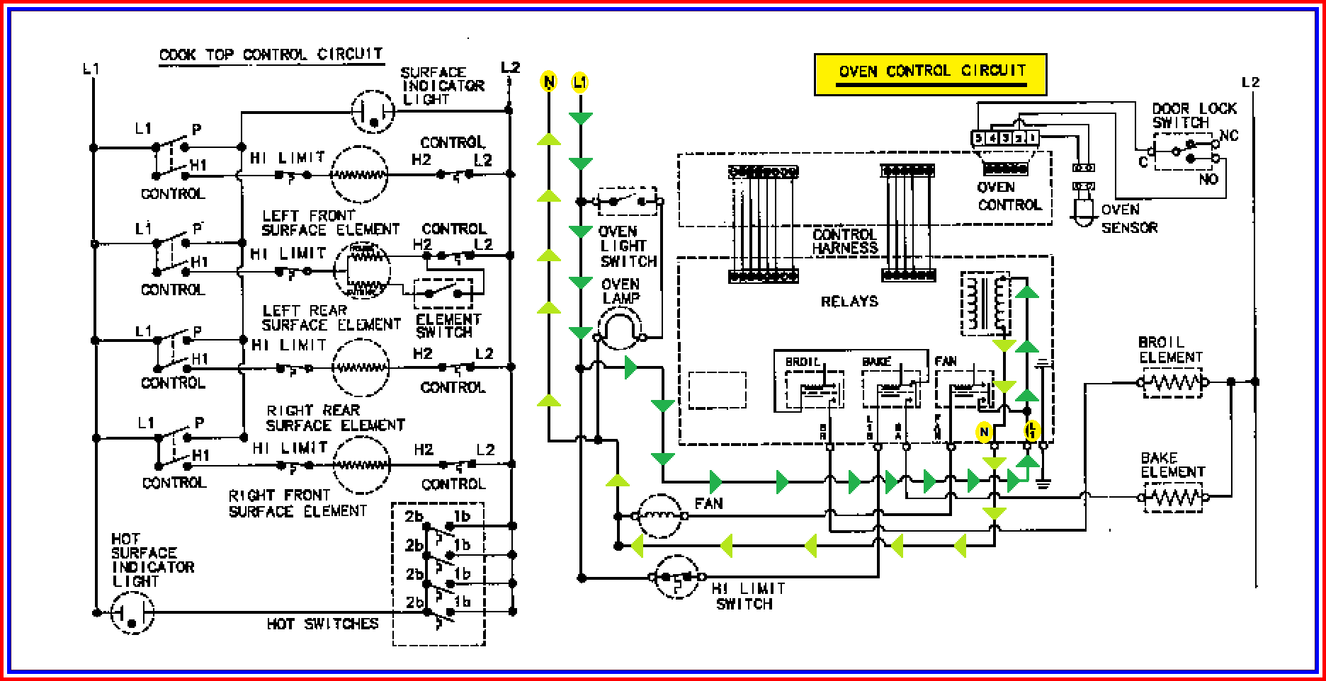

Consulting your wiring diagram for the oven portion . . . indeed one 120 V leg of the AC power . . . L1 and N . . . . . is fed to the power transformer .
Pull the crowfoot AC power plug and ohmically test the GREEN arrow path for about 15-20 ohms for the primary of the power transformer from TOP corners L1 and N power input.
If that then confirms, a powering up and reading of the 1-2 3-4 terminals of the secondary should confirm reduced AC voltage there.

Sir wuoshi103 . . . . . . . .
Very important . . . .
DId you ever do a no power applied test and confirm that there was ~ 15 - 20 0hms of resistance between the
transformers primary winding , which I drew in on the Post # 9 reference drawing,. and if so, you should also read it again when testing right across the two nearby N and L1 terminals of the PCB..
PLUS . . . . . if you leave one ohmmeter lead at the mentioned L1 terminal and probe to the three blades of the unplugged AC power crowfoot connector, you should read almost zero ohms to ONE of its blades and that 15-20 ohms to another blade.
Then, as a DOUBLE test, move the ohmmeter wire to the N PCB connector and use the other ohmmeter probe to test to the three blades of the power crowfoot connector again and expect a like confirmation, but with the zero and 15-20 ohm readings of the blades being reversed.
If you never read that transformers primary resistance presence, either it is open or you erred in the reading of the almost zero resistance of the transformer winding areas internal thermal fuse.
RE-REFERENCING :
http://i.imgur.com/tzIxpCc.png
If you never find that 15-20 ohm primary winding, refer to my Post 3 drawing where the RED referencing lines ends actually end at the points where the primary wires are wound around and soldered onto those specific larger gauge wire terminals.
Do a direct ohms probe at them as a final confirmation..
That testing that you just did confirmed that all is well from the AC crows foot, right up to the L1 and N connector that are right beside the Power Transformer.
Now you just need to concentrate on the few inches between the L1 and N blade connector and the Transformer.
Until that 15-20 ohms show up, we have no transformer primary.
Refer again to the close up of the transformer just below.
The L1 connector blade travels directly over to the #1 terminal of the transformer
That has AC power into ONE end of the transformers primary winding.
The N connector blade travels directly over to the #3 terminal of the transformer
and that goes inside and into one end lead of the one shot internal thermal fuse, with the other lead of the fuse routed to the #6 terminal of the transformer.
There is a foil jumper which connects term #6 over to terminal #5 and that #5 is the
connection point of the OTHER wire of the primary of the transformer.
Ohmming out from term 3 to 6 should reveal a very low/shorted reading, if the thermal fuse is GOOD.
NOW ohmming out from terminal #1 to #5 should reveal the 15-20 ohms of the transformer primary.
IF not . . . heat up ye olde soldering iron and concentrate on heating up the wire terminals where my RED lines mark ups end at #1 and #5 and pushing the melting solder into the cavity with the stiff solder . . . . let warm up for an extra 5 seconds for reflow bonding.
Hoping to get an internal solder blob as large as the one seen on terminal 6.

Sir 73s de Edd,
Thank you! you are right on the dot. it was the primary leg 1, the winding originally attached to it had came loose or broke/burned off (likely due to overheat, my mom must have accidentally left the oven on when she visited me two weeks ago, no wonder my house felt so warm that week).
I used a blob of solder to make a connection to the primary leg 1 to the winding. After i've done that I could measure 0.16 ohn between N and L1 and primary leg 1 and leg5. Plug everything back in and turn on the power. the clock is back up and oven is working again.
