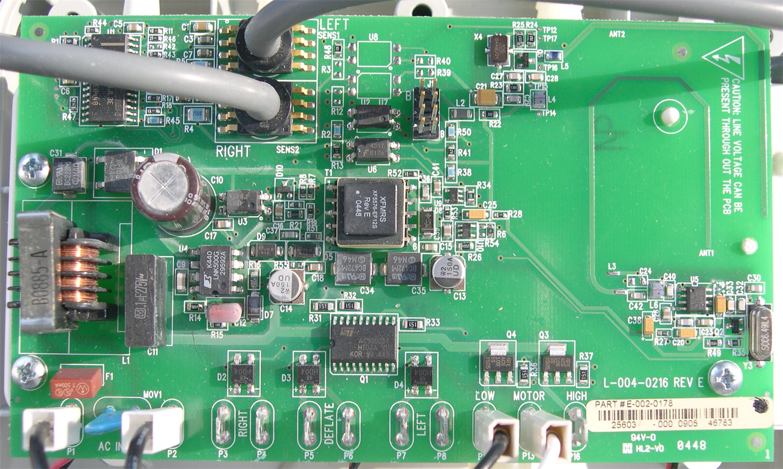

Maybe look on eBay to see if anyone has a replacement control board for sale. Can you post a pic of the board? One of us might recognize a fuse that you don't.

Here's a pic of the board.
I shorted between P4 & P5 at the bottom of board. P3 & P4 are labeled 'Right' and P5 & P6 are labeled 'Deflate'.
I noticed the square, rust colored component as I was editing the photo. It is marked F1. I thought it might be for fuse and it IS in the line voltage circuit. So, I checked the continuity of it and it is open. Could that be the culprit that popped?
you may be lucky to have got away with that as the only damage :)

It looks to my unknowledgeable eyes to say 500mA on the top of the fuse. For a permanent fix, I need to find a replacement with the same specs.
Could I get a away with substituting a different fuse of higher amperage just to see if the rest of the circuit & components function?
not unless you want to kill the rest of the circuit if there is yet another fault
a fuse of given rating is used for a reason .... protection
get another 500mA fuse or 2 :)

Ok, I got lucky. I picked up some 500mA fuses yesterday and replaced the popped one. Everything is working again.
