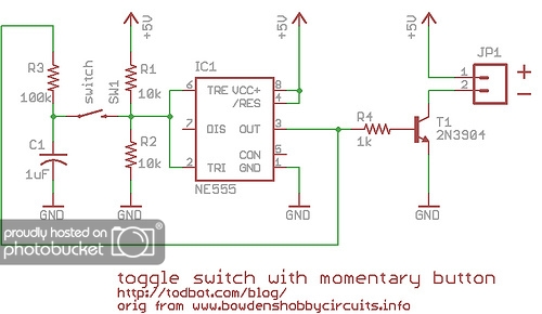

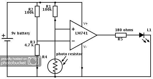

Hello, first post on the forum. I'm looking for help with a school project. My electronics professor is an idiot, so to the forums I go. I'm wanting to use a laser pointer to turn an LED on and off. Our project has to include an op amp and a 555 timer, so what I have come up with is using the op amp as a comparator and using the 555 as an on/off toggle. I'd like to use two photocells, one as the reference for the op amp and one as the trigger. This way I can set the ambient light as a reference and the laser will trigger. I'm wanting to do this so ambient light won't trigger the op amp. Does this sound plausible? The op amp will act as a momentary switch, allowing the 555 timer to toggle an LED on and off. I have found two diagrams, one using a single photocell and an op amp as a comparator, the other using a momentary switch with the 555 timer. I would like some help putting these two diagrams together, as well as incorporating the second photocell as the ambient light sensor. I posted the diagrams I have found below.
Also, I know very little about photocells. I know they come in different sizes, but do the sizes have different resistance ratings? I would like to use a smaller sensor as the ambient light sensor, and the other as large as possible to allow an easier target for the laser.

1. Because I have to use an op amp. This is for a class project and that is part of the grade.
2. I don't want ambient light to trigger the circuit, so using it in a comparator circuit with either another photocell or a potentiometer should work, right?

You could use the 555 as an oscillator to drive the laser, and configure the opamp as a bandpass filter to detect it while rejecting ambient light interference.

I'm here to report great news. My op amp circuit works perfectly, exactly how I wanted it to do. Instead of using the above circuit exactly, R1 and R2 are photoresistors, R3 and R4 are both 100k resistors. The photoresistor at R1 acts as the ambient light sensor, and when I aim the laser at the photoresistor at R2 it triggers the op amp. This happens in any light condition, which is why I wanted to use the op amp in a comparator circuit.
I was also able to get the 555 toggle circuit to work correctly, now I only need to put them together. I bought a relay without realizing that it is a 5v relay, so now my options are to use some extra resistors in a voltage divider to drop it down to the appropriate voltage for the relay, or try to find a 9v relay that is similar in size. Which would be more appropriate? Is there a better solution to connect the two circuits?

How have I over designed the circuit? In the circuit you provided you are using two sensors, one for off and one for on. I do not want to do that. I also do not want to trigger the circuit with an ambient light source, which I'm assuming your circuit would have.
Again, I am REQUIRED to use a 555 and an op amp (LM555 and LM741), both of them, in either two projects or combined for extra points. I do not care if it isn't ideal or isn't what you would have done. It is what I have to do in order to pass this class.

Well I was able to toggle it using the 555 in the circuit above. I plan on using a relay in place of the switch, and input from the op amp to trigger the relay. If I use the 5v relay I have, which is the only one I found at Radio Shack that would connect to the breadboard without taking up a lot of space, I will have to run the output from the op amp as well as the power for the relay through some voltage dividers so I don't burn up the relay with my 9v power source.

Show us the circuit you have now.
perhaps you can make the LED flash when the beam is detected?

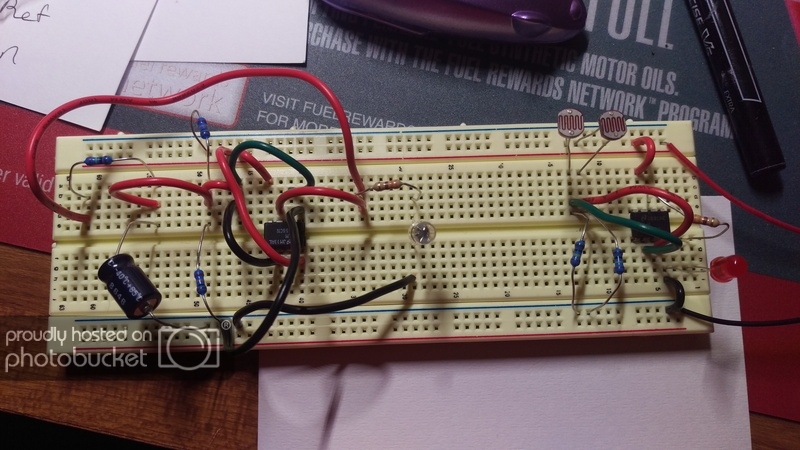

I don't have a complete circuit yet, but I could take a picture of the breadboard if you would like. I can also take a video of the two functions working separately.

This is my first electronics project, so go easy on me lol. My breadboard is a complete mess. The left side is an LM555 in the same circuit as above, except it is toggling an LED. The right side is close to the op amp circuit above using an LM741, but with the changes I mentioned a few posts up, and is currently powering an LED.

Here is a video of both circuits working, just not together. Please excuse the "plugging and unplugging" of the wire instead of using a momentary button. I didn't buy a button since I didn't really need it for the final circuit. It is also kinda hard to film and do these actions at the same time, so I don't expect to win any awards for great filming.

Look at the functions of all the pins of the 555. Perhaps you can find one that can turn the oscillator on and off. Maybe the 741 could connect to this and avoid the need for a relay.

The photo is nice, but in electronics, "show us your circuit" means show us the schematics. It sounds like you're most of the way there except for some kind of interface. Show us your circuit.
