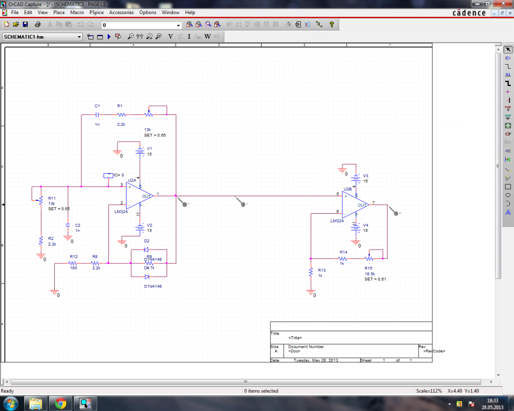

Greetings everyone, i have a assigment and i need to create a wien bridge oscillator that uses potentiometers so the out freq can be modified between (10, 14 )kHz...and the out voltage between (6,9) V ... i already made a sketch but i just cant figure out how to do this...every time i try to make the amplitude bigger the frequency changes and the other way around. Please, can someone help me ?

Welcome on the forum.
1) I moved this thread to the homework section.
2) A Wien bridge is a rather delicate thing. Separate the two tasks (setting frequency and setting amplitude) into two sub-circuits.
Build the Wien bridge oscillator with adjustable frequency (changing R1 and R2 simultaneously will require a stereo potentiometer).
Add an amplifier to decouple the oscillator from the load and to adjust the amplitude independently from the frequency.

To change the frequency you change R1 and R2 or C1 and c2. Changing R is a lot easier. So use a linear stereo potentiometer instead of R1 and R2.
See this tutorial on Wien bridge oscillators.
You already have marked the output of the oscillator with a green pin.
Add any flavour of amplifier at this point. I suggest you use a noninverting circuit (the link shows the circuit diagram).

so you are saying i should use the first immage i attached
and replace the rezistances on the wien bridge with potentiometers to change the frecvency and then use the other amp(img2) in series with the wien bridge amp and there change the amplitude of the sine waves?
Harald Kapp
Nov 17, 2011
14,317
Nov 17, 2011
14,317
Exactly- Vout of the Oscillator is Vin to the amplifier.
Use a potentiometer in place of R2 and Rf of the amplifier to adjust gain (>=1). If you need gain <1, insert an attenuator (resistive voltage divider) between the two circuits.
Note that you will need some kind of stabilization for the oscillator to output a reasonable clear sine wave. Often a simple incandescent lamp is used, as in this example.
Otherwise the oscillator wil stop oscillating if the feedback is to small, or will distort the signal if feedback is too high. You can't reliably set resistors R1 and R2 of the oscillator to perform equally well across all possible circuit variations (temperature, supply voltage etc.)

by giving this values to the potentiometers in the first ao, whenever i max the potentiometer (value=1) i get the lowest frequency but to make it 14 khz the highest frequency i need i have to turn the value to 0.65 ....how can i make the potentiometer value to be 0=14khz ...value=1 ...10khz ?
Harald Kapp
Nov 17, 2011
14,317
Nov 17, 2011
14,317
Since your pot is 13k, you vary between 1*13k=13k and 0.65*13k=8.45k.
Therefore you can replace the pot by a fixed resistor of 8.45 plus a potentiometer of 4.55k.
Practical values could be 9.25k (from the E96 series) for the fixed resistor and 4.7k for the potentiometer.

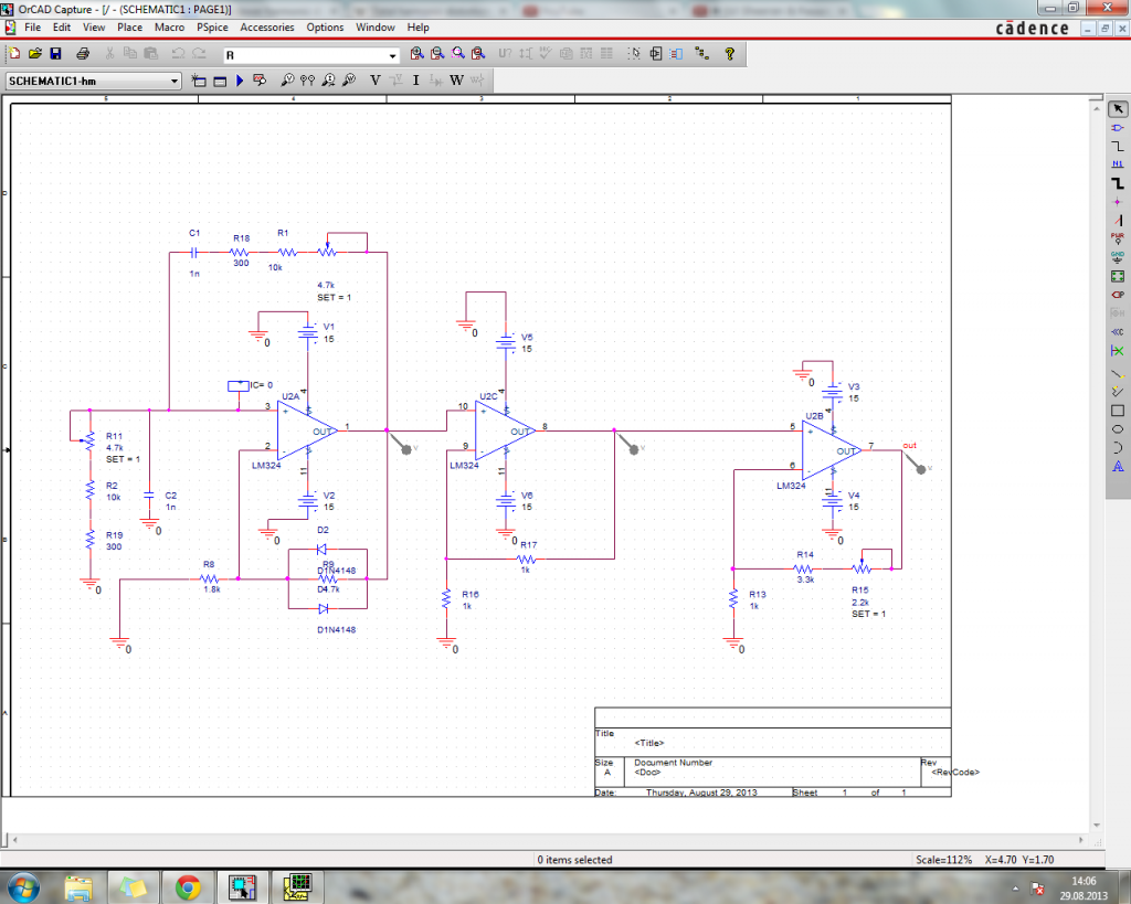

Hey guys...its me again
I really need your help...iv finished my design only to find out that my total harmonic distorsions are 60%!
can someone please help me reduce the harmonic distorsions?
here is a picture of my circuit
(*steve*)
¡sǝpodᴉʇuɐ ǝɥʇ ɹɐǝɥd
Jan 21, 2010
25,510
Jan 21, 2010
25,510
Do you have an oscilloscope?
What does the signal look like at the three points you have marked?
Why do you have that buffer between the oscillator and the amplifier?
Raven Luni
Oct 15, 2011
798
Oct 15, 2011
798
Disclaimer: I'm not particularly knowledgable about this stuff and I'm just speaking from experience of my own dabblings.
Diode stablisation works well if you catch it right at the point where they begin to conduct. Replace R12 and R8 with a variable resistor and you'll be able to hear the difference from a smooth sine wave when it begins to oscillate to the distortion. It puts a strict limit on the output voltage so I would recommend putting a buffer there to counteract any loading from the second amp stage.
