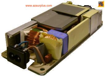

i had a question...in most power supply pcb i found special sort of caps with transformr, (a ring wounded two coils as can be seen in the pics attached... )
images
http://jimson.com/jimson/products.asp?id=32

is there any stability or performance related or is it a protection part

Those capacitors and INDUCTORS (edit) perform a dual purpose. Firstly they help suppress noise on the power line from reaching the power supply. A more important purpose for a switch-mode power supply (like the one in your image) is to prevent high frequency noise from the regulator from reaching the mains and causing interference.
edit: I meant Inductors, not resistors.

but this was not the ciruit iwas reffering... it was just to show that coil of the transformer

the one where i see it is not smps... and u did not answered about the transformer... its a ring shaped core that has two windings... can u give me such a circuit .. its schematic.. so that i can understand how its going to be used

Look here.
DR1, C1, and C2 on that circuit diagram are what you're probably looking at.
DR1 is a pair of inductors on a common core. Similar to a transformer (but used in a different way).
Another example, drawn in a slightly different way. In this example the capacitors are placed slightly differently.
