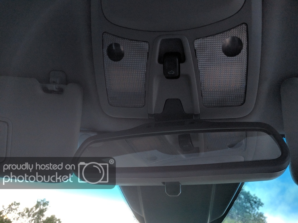

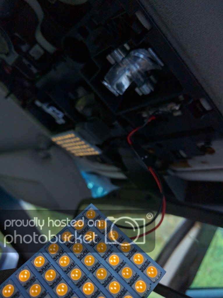

I've swapped out the incandescent bulbs in the dome light in my car for LED plates from eBay with 48pcs 5050 SMDs per plate. Being eBay stuff, there's not very much information or specs, least of all watts, amps and the likes.
The car is from 2007 and every module in the car is on a CANBus network, meaning when the car is running and the network is active, the LED plates glow dimly. This irritates me something fierce. I've been led to believe I can solder in a resistor either in series or parrallel with the LED plates to solve this, but my electronics skills are like I said, next to irrelevant. Any help here would be greatly appreciated. What ohm value would the resistors need to be, and in series or parrallel? What specs would you need on the car or LED plates to calculate this?

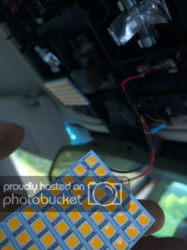

Success! Got the 1kOhm resistors in the mail a few days ago. LED plates without resistor:
Resistor tested on one of the plates:

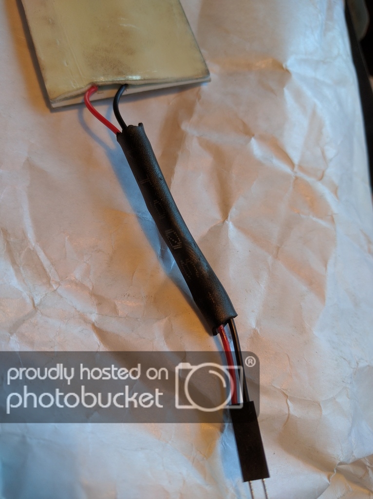

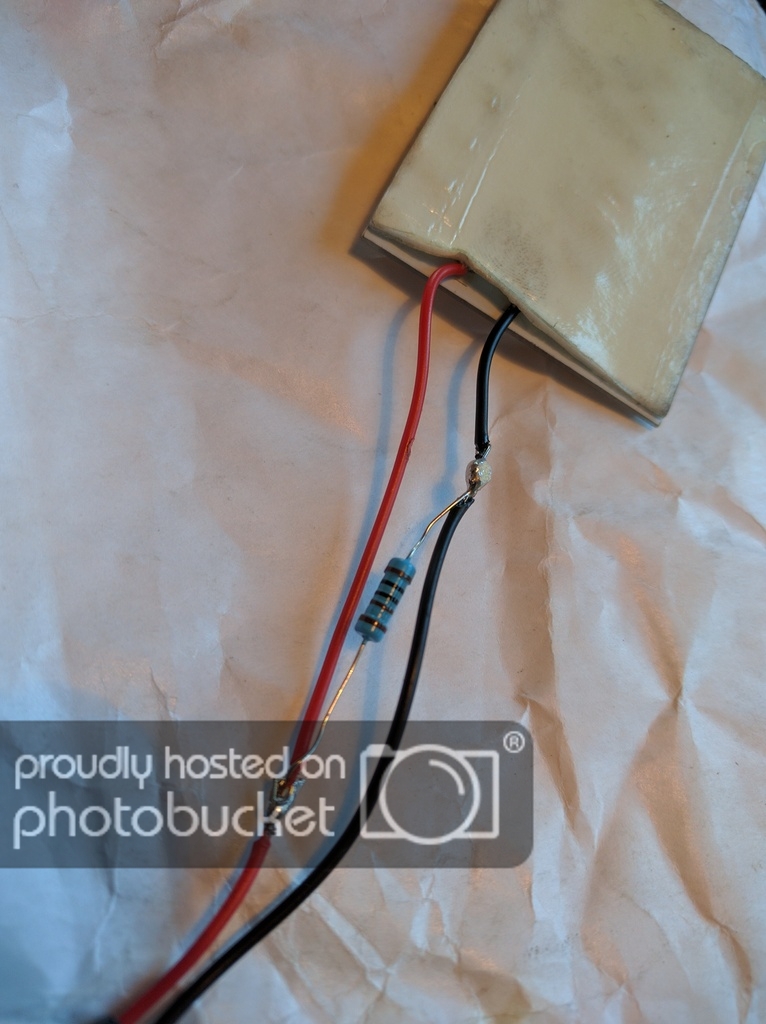

Completely dark. There has to be one output from the Upper Electronics Module to both these two and one dome light in the back seats, because adding this one resistor made all three go completely dark when switched off. Soldered in and shrink wrapped:

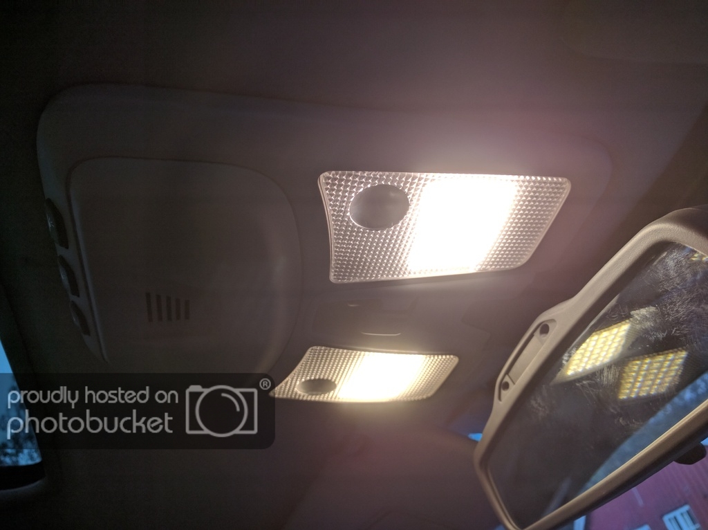

Completely dark when off, lights up like hell when on.
Thank you very much for your help. I drive alot at night, and this has been a real nuiscance.
