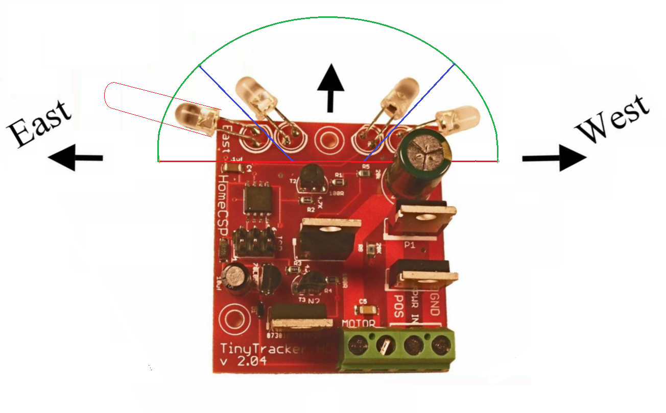

Thank you, Minder. That was the thought we also had.
At the present we are (were) using a small LED electronic sun seeker board purchased from Ebay. Like we mentioned above, we never could get this thing to behave - it was always confused by stray light from everywhere which is the reason we'ver been working on the Pysolar and Jay Dosher's programs (+ the IMU and H-bridge). i imagine the LEDs provided the feedback and the circuit on the board made the comparisons until the values of the LEDs were equal.

Sir frazelle09 . . . . . . . .
First of all . . . . for mere simplification of the problem . . . .
Did you utilize. light restricting, long flat black light tubes to channel in your sampled light source . . . .thereby eliminating your
"getting confused by stray light from everywhere."
Further refinement . . . . .
After viewing E-bay offering and its sensor design and additionally seeing the quite complete, supplementary u/p incorporation.
Initially try flat black heat shrink tubing on the LEDS that could be trimmed down in overall length as needed.
As is being depicted on the one far left unit.
If that doesn't work pull them and try:
Secondarily . . .thin, flat black, semicircular discs could be fabricated with one going on very bottom and the other spaced up the distance of LED diameters up and it being the top cover unit.
Pattern profiled as being depicted with the RED/GREEN outlining.
An added flat black baffle at the rear at the RED line seals off that end from any ambient light entry , optional thin separational baffles cemented in at the BLUE lines if needed.
The overall resultant effect is overall ambient light shielding from all but the select frontal semicircular slit.

73's de Edd, thank you for posting! Yes, we tried what we thought was everything to reduce the stray ray problem.

OK then . . . . .how about a timer to power up the system only in incremental time slots.
The use of a photo cell to initially detect valid sun presence and then the timer only supplies power every 15 minute period, needing JUST AN INITIAL 15 second servo micro tracking correction, then no power present until the start of the next 15 minute period, wherein it corrects again .
Then a photo cell sensed shutdown until the next day, when it all starts again.
By that powered down procedure you can only have "stray" ambient light problems in 15 second time periods every 15 minutes
Of your opted drive trains, I still like the simple Grainger unit, pending its having adequate torque, as this unit only needs to make fast micro adjustments thru the day.

Infrared-transparent black caps over the photo sensors might help with the stray light problem. Most plastics are transparent to infrared radiation. Or just use a black plastic strip in front of all the sensors and mount the circuitry in a light-proof box, maybe covered with aluminum foil on the outside exposing only the infrared "window". Does this contraption mount on the parabolic reflectors and move with them? It should, but it appears to be mounted on a pole separate from the trough reflectors.

Darn, didn't see that last post, hevans1944! Sorry about that.
We had mounted the LEDs on the parabola itself until we began to get light interference problems - as well as the concentrated beams melting some of our mounting hardware - lol.
So we mounted the LEDs on the pole to which you are referring which moves with the parabola but never could get it out of the stray rays...
