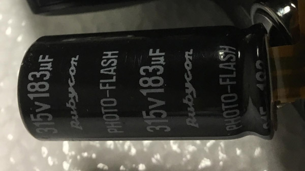

Hello,
I am looking to replace a capacitor that is 315V 183uF. I am not finding this particular part anywhere so I will need to settle for the next closest thing.
I assume I can go with any voltage above 315 but for capacitance, do I also go above or just find the closest match? Physical size is also an issue as it needs to fit inside my camera so I am under a number of restrictions. I am unable to find the part on any Sony camera parts website.

It is a very common value, obtainable from a disposable film camera. Will have to dismantle a few to pick the correct dimension. I have about 2 dozen different... if you specify the size. And a variation in capacity should not matter much. Should be for the flash circuitry.

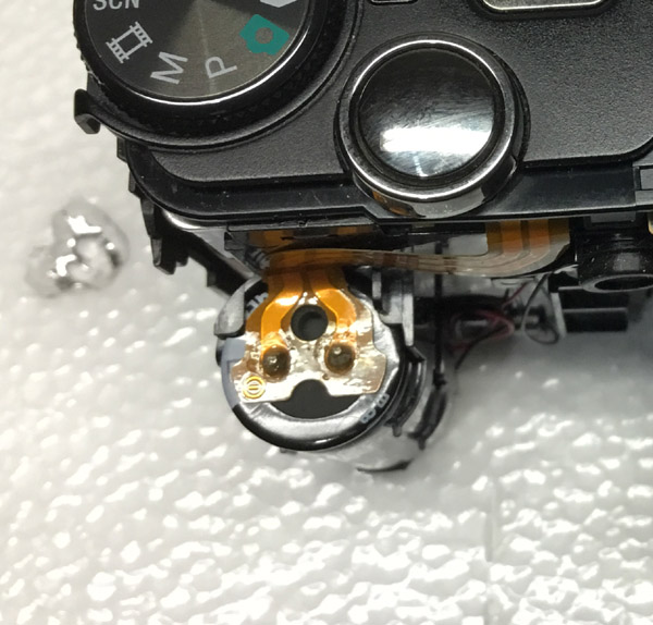

I am not positive I am kind of taking a shot in the dark. The flash was failing on the camera and it appeared to be the flexible cable because when I would twist the pop up flash slightly then it would work. I replaced the flash cable with a new one (complete assembly) but in the process of discharging the cap, I made a nasty spark across the terminals, and now even with the new part, the flash pops up but does not flash.

That 'nasty spark' showed the capacitor was good, holding charge; and delivered a lot of energy into somewhere, frying something else.
that capacitor is to be discharged with a resistor across for a while until reads 0Volts.
You may have something else badly vaporized in the circuitry.

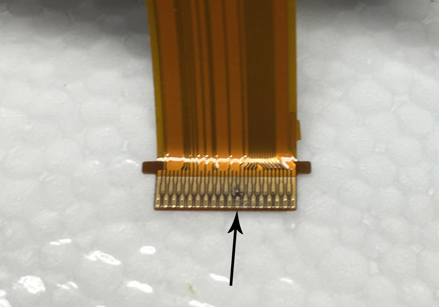

Thanks for the tip. The capacitor is fine. It held the charge. Looking closely I think this is the problem. It must have touched the charged capacitor when I was moving things around. Almost looks like a drop of solder that is causing a short circuit.

Hope cleaning/scraping/fixing that works. You will need to work under a microscope and with very skilled hands. If not successful , whatever connects to those traces may be affected.
And observe carefully, that several traces are the same connection.

Even looking at it with 6X reading glasses you can't see as much detail as this photo shows. I am going to get a hold of a microscope and take a closer look. Helps to have a wife who is a teacher :)

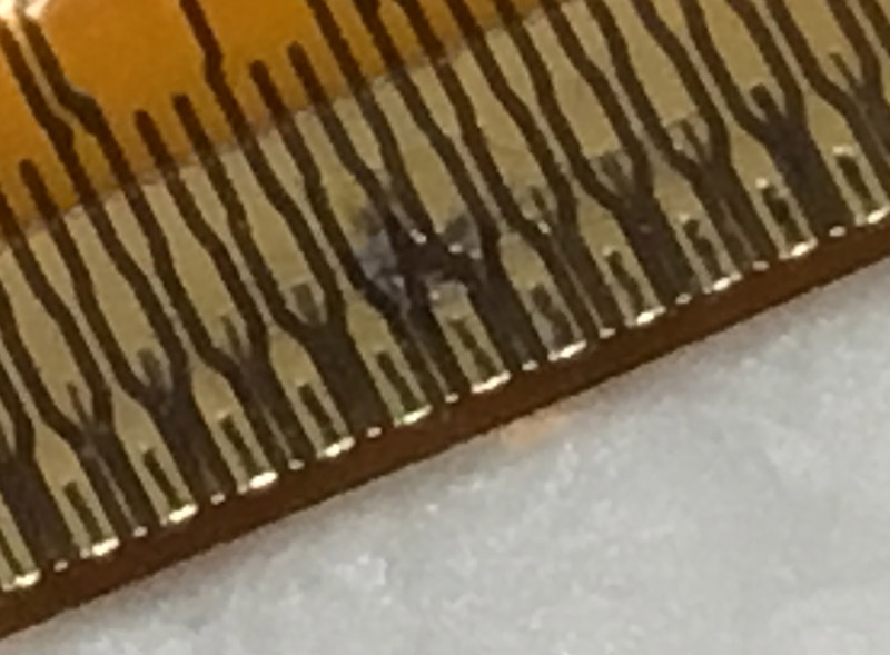

Sir RichO . . . . .
I think that where I have the LIME GREEN circle, that is possibly just being up reflected light from a very shiny surface.
BUT over on the damaged portion of the ribbon cable fingers, seems like the very widest paths would be attributable to photo flash cap proper wiring on the A and B paths.
The common PINK-RED-GREEN branch out with PINK seeming to have escaped unscathed, while the bottom tips of GREEN and BLUE have been blasted away, and RED having been the worst, with its intermediate path vaporized.
One could only hope that individual BLUE line is not being UBER critical, and any voltage getting over to it could not have caused any fatal damage.
The original pristine condition being shown at the bottom inset.

Looked at it with a microscope and at least one of the paths has clearly been vaporized if not two. Was able to get a close up photo with my iPad camera. At this point I am just going to go ahead and purchase the used camera for parts. It costs a lot less than buying this replacement assembly. Thanks again for all the help.
