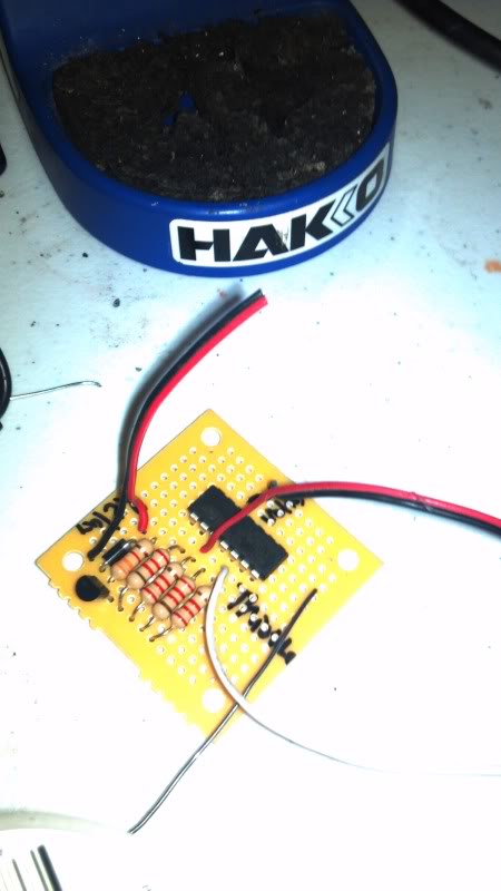

Done, I hope I followed everything correctly

If you haven't powered it up yet, and you have a multimeter, here is what I would recommend:
1. Check the resistance between the power leads. It should read a few K ohms. If less do not apply power.
2. Put a resistor of 1K or more across the relay leads.
3. Connect the throttle input to ground, and measure the voltage on the relay lead coming from the transitor. It should read 24V.
4. Connect the throttle middle of the 4 resistor chain. The voltage on the relay lead coming from the transistor should now read < 1V.
If it passes all of these tests, you can hook it up and hope for the best!

could you please re-describe #4. It doesn't make sence to me:D
BobK
Jan 5, 2010
7,682
Jan 5, 2010
7,682
I missed the word input. The throttle input should turn the transistor on when connected to > 6V and off when connected to < 6V. The middle of the 4 resistor chain should be at 12V so that would be a way to test for it going on.
Actually, a better test would be to just connect it to the throttle controller and see if it turns the transistor On when twisted in the forward direction and off when not. This without the relay connected so that you don't go starting the motor.
Then then next step would be to disconnect the motor and connect the relay and make sure the relay operates when it should. Finally, connect the motor back on.
Edited: BTW if anything smokes, disconnect the power and come back for advice.
