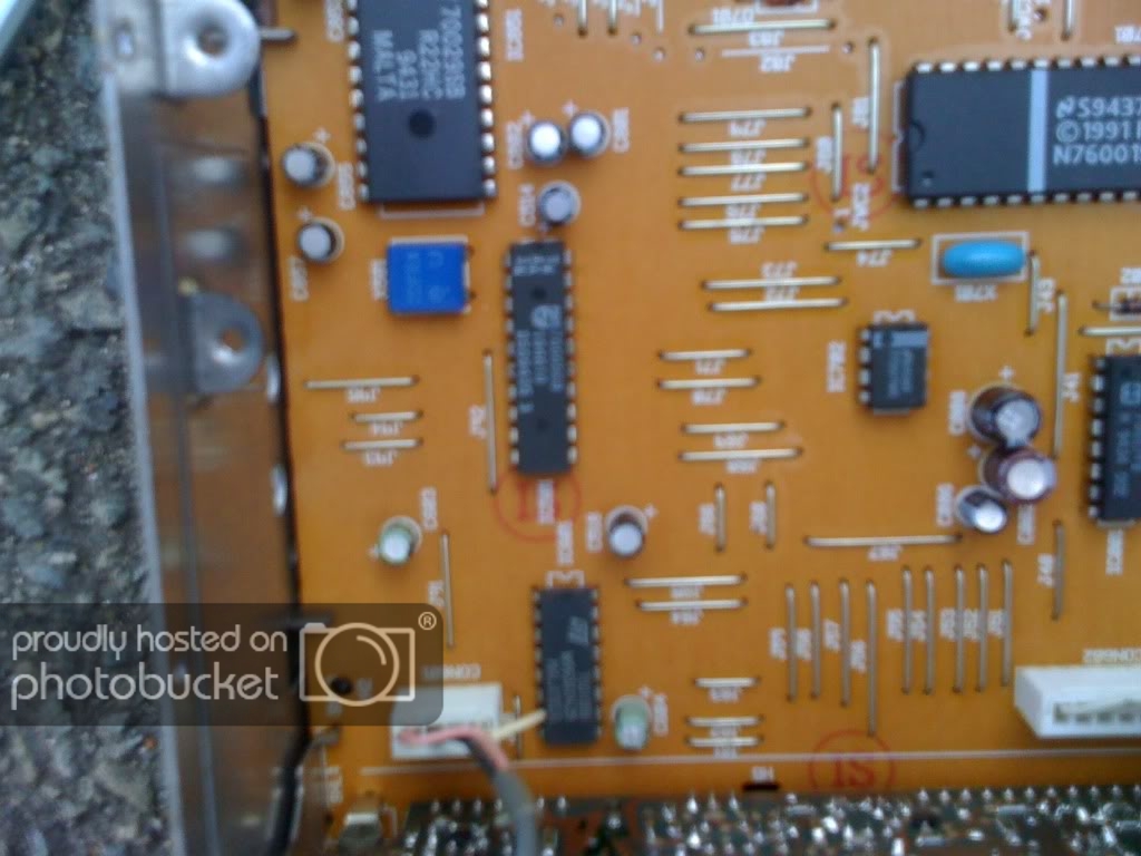

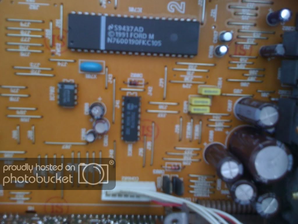

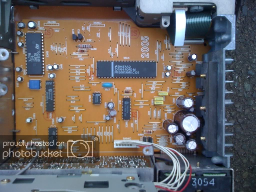

Ok, googling is an absolute pain. I do have some pictures of the internals after wondering about this many months ago and thought I'd take them just in case.
The two white connectors (CON601 and CON602, but the zero's do look like an 8 in the pic) at the bottom both go into the tape deck mechanism. In the first pic the tape deck mechanism is basically removed and stood on it's side on the edge of the unit casing. The grey wrapping on CON601 does remind me of the audio wiring in some other things I've seen (CD audio wires in a computer to the sound card).

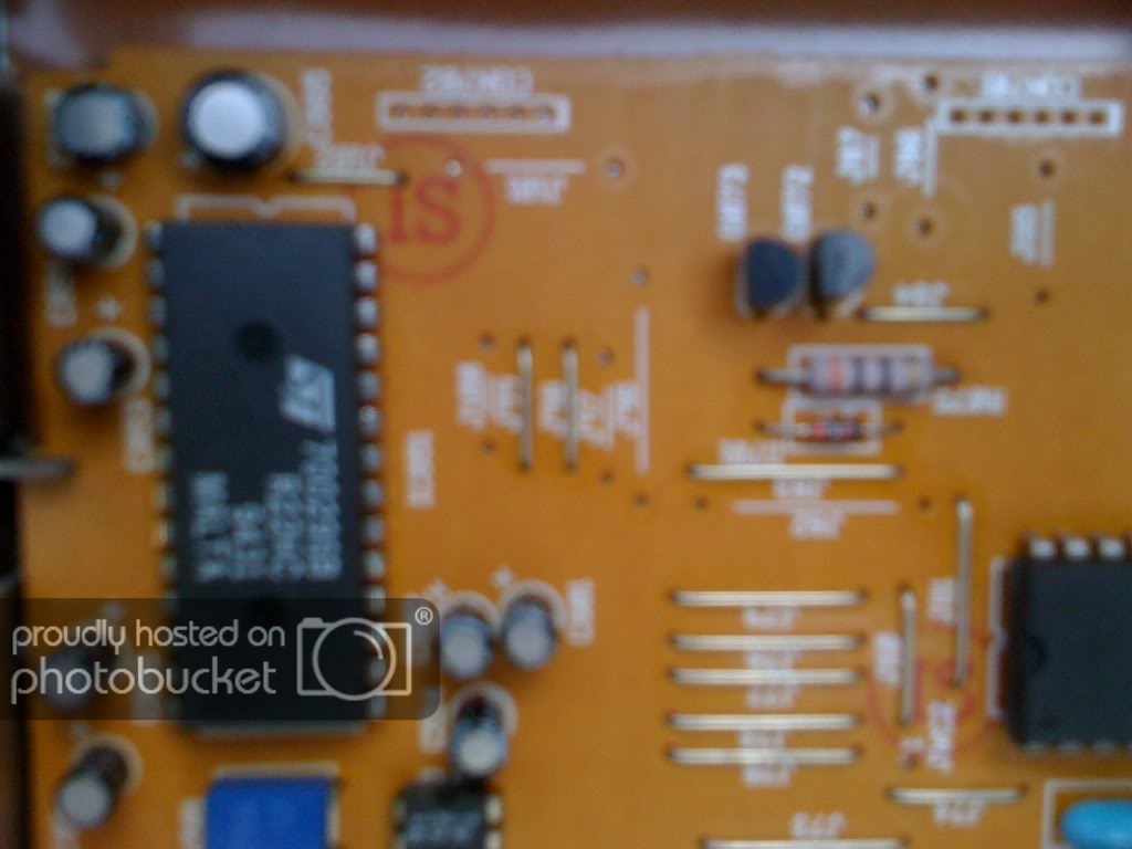

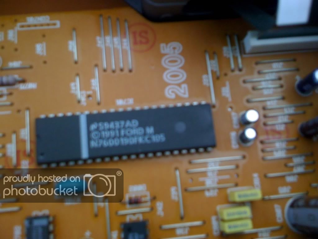

hi Dan,
unfortunately, the last 3 pics are a bit too blurry to get any real info from
can you confirm that that grey shielded wire in the lower left actually goes to the tape head please
DONT put ant power across those wires, you will kill the preamplifier. That tape preamp will be too sensitive for a MP3 player input we will need to insert the MP3 signal further up the line. Hence why we really need a cct diagram to see what those chips are and when we can connect a signal into.

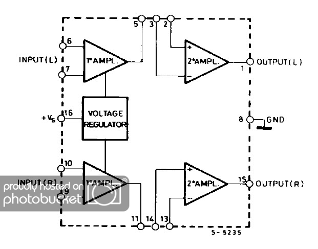

Looks like I've found the pre-amp. I know this has to be bypassed in the case of the tape player to line input conversion as the audio is already boosted by the iPhone itself and other people have already reported blown stereos, speakers, car looms etc. So all I have to do apparently is intercept the outputs from these.
Here's the schematic:
So from what I can tell, solder onto the very easy to get wires (yeah, not PCB on this section in this radio!) and cut the section between my solder joints and the IC.
I just ened to remove the radio again, and confirm the inputs of the IC are from the tape deck.

yup you could cut PCB tracks leaving pins 1 and 15 of that chip. That is after confirming that the radio doesnt get pre-amped with that chip as well.
report back and let us know what you find :)
