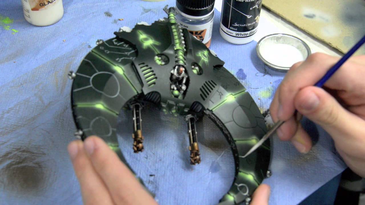

For reference, this is the model I am going to adapt it to.

Are the green lights LEDs or old fashioned light bulbs?
A 4017 has 10 outputs for LEDs but a second one can be added for more outputs.
Will you power the lights with a battery or with an AC-DC power supply?
actually, that is really talented airbrush painting. NOT mine. I wish I was that good.

so that model is hollow. I need it to run on one of those flat batteries.
