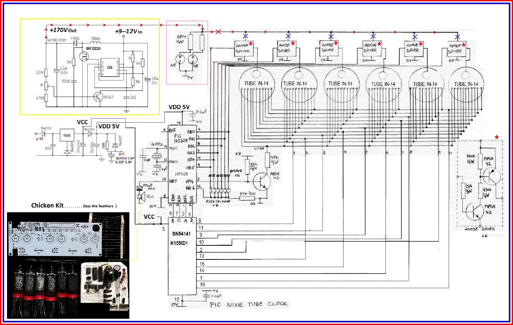

Sir jacktron . . . . . . .
I looked around and couldnt find your EXACT Lithuanian sourced ? unit, but found the same PCB look-a-likes being used on some RUSSKIE units.
Check out your unit against this schema and see if its basic design does also hold true on your specific unit.
I took SPECIAL interest in your video of the two s.t.r.e.t.c.h ed out electrodes of the quasi NE-2 lamps, that are being used as colon separators between digit set pairs, and that they were ALSO flickering , along with the very noticeable nixie display segments.
Now, by referencing the schematic . . . you can see that each one of them are being continually left on and that their power is fed by the ~170 VDC through a series dropping resistor for each.
The additional colon displays flickering, would therefore seem to be indicative of either an erratic 170 VDC supply source or some item also being fed by the power supply on downstream, is likely going into an intermittent / sporadic avalanching mode and erratically pulling down the 170VDC supply line.
If my problem to solve, I would initially refer to the supplied schematic mark ups, which will show that the 170VDC regulated supply source is being generated within the top left corners YELLOW box.
Its voltage supply follows the RED arrowed line and initially feeds the two neon lamps used as colon indicators.
Then the power flow is to the right to each of 6 discrete built up anode driver switching blocks (RED STARS) that are being component defined over to the right side as per their manner of build up.. . . . its marked with a RED STAR also.
NORMAL OPERATION . . . . .
of this unit would be having 170 VDC being initially fed to the individual neon colon indicators and then since this is a MULTIPLEXED display, pin 1 of the PIC16F628 u/p activates the MPSA42 transistor within the first anode driver block which then creates a base drive signal to its companion MPSA92 high voltage driver transistor.
That conduction has power completion to the anode of that first nixie tube . . . meanwhile, back in the jungle, at the SN54141 BCD-TO-DECIMAL DECODER/DRIVER, at its ABCD decoder inputs from the 16F628 u/p it is simultaneously receiving info to see which digit is supposed to be activated on that first nixie, and that 54141 chip completes the power loop to ground internally.
THEN the same procedure is repeated for the next nixie digit, on down thru the 6th nixie tube, THEN the whole sequence through the set of nixies, repeats again.
Since this rapid on and off sequencing through all of the digits is occurring quicker than the human eyes ~200 milliseconds response time of vision, a persistence of vision fools the eye, and it makes it seem like ALL of the digits are continually being displayed.
Should one of the MPSA92' s avalanche C to E , an adjunct voltage spike could travel backwards into the pins 6 thru 11 pins of the PIC16F628 u/p, as they also serve as address lines, when setting the clock through the 6 steering diode matrix, which you see sitting just below them.
That could then upset all counting sequences and produce totally irrelevent numbers and timing, or even drop counts.The current situation is even heard encroaching into the drive to the piezo speaker of the unit.
TESTING:
Trying to pinpoint those erratic voltage changes and drop outs could certainly be problematic , when attempting to use either an analog or DVM. . . . . by . . . slow metering indication response time.
Fortunately, you already have something encroaching upon a scopes analysis capability, in the form of those two neon colon indicators.
Note the RED X just past them, for the first test, open that circuitry at that point and power up then to see if the colons are being in a steady on condition, but they may be a bit brighter, due to no downstream supply load.
If the same prior flicker-flashee flashee still persists by them, the 170 VDC power supply is suspect and needs to be worked on.
If having a steady lit up set of colons, then restore the RED X broken connection and try the sequentially disconnecting of each of the BLUE X supply points one at a time.
That would isolate a bad circuit combination . . . . . . . likely expecting an anode driver ciruit block,
Thaasssssit . . . . .
