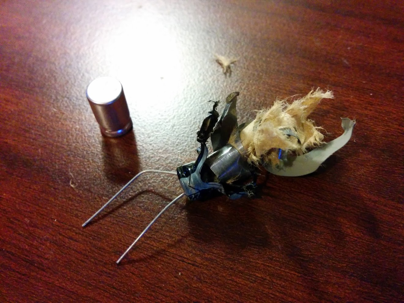

Yes the 2 green ones are what I need to find out what they are naught a speaker with both blown to the point it's like a brown fuzzed teddy exploded I'm trying to fix it now. I'm trying to post a pic to show but it's not letting me

Sir Moe . . . . .
O.K maybe I am just needing more in depth detail of your . . . . .
" are naught a speaker with both blown to the point it's like a brown fuzzed teddy exploded "
As I was interpreting that above statement, I perceived of the speakers being the ones "fuzzed".
Since those TWO green E-caps are being the two initial input filters, receiving DC power from the separate switch mode power supply on another board to the side. The large 3 pin white connector and its wiring interconnects them.
JUST replacing those two " exploded ? "' E-caps isn't going to do diddly "merde" for the apparent SERIOUS over powering / voltage subjected to them . . . . from what must be a dysfunctional main power supply.
Aren't the E- can tops / cases still around, to be able to read their plastic covers markings ?
If the two caps are being the fuzzies you referred to, I am expecting this type of scene . . . .
Which should still relate to their having receiving too high of ripple voltage or too much voltage from the units power supply.
Define the . . . . . are naught a speaker . . . . do they seem to be good ?
73's de Edd . . . . .

yes thats exactly what happened but no theres no plastic arround at all anymore. and i meant i bought a speaker sorry was typing on my phone

If this unit is being your originally purchased and a working unit and was last working, and then at your next attempt of use, it no workee, there is a dual possibility.
One, is being that you turned on the unit and then there was the EASILY heard BANG- BANG of the two caps EXPLODING .
But . . . BUT . . . BUT . . . there is ALSO a like possibility, that this BIG BANG-BANG happened when you were not even home, because I FULLY think that this units, earlier mentioned, power supply section, circuit board, runs in standby power mode 24 hrs a day and only REALLY turns on to full power with your command from the units frontal power pushbutton or remote control . So its fuse may now be blown.
NEXT HOW DID THOSE TWO E-caps, EACH BEING IN SEPARATE SUPPLY LOOPS, GET SUCH A TREMENDOUS JOLT TO TOTALLY DESTROY THEM ?
S0 . . . what is your power line voltage 120 or 220 VAC ?
Have you had any power outages or other electrical items / lamps failures in the household . . . . or had any close lightning bolt hits to your houses AC line power pole ?
Your sole circuit board portion being involved with now, is not associated with causing . . . .BOTH . . .of your two GREEN E-caps to explode.
