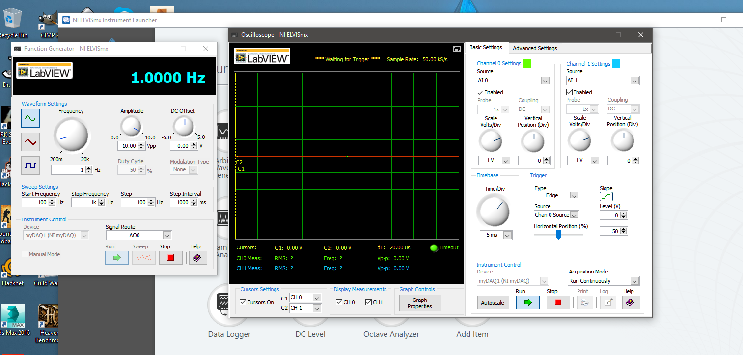

Hello guys,

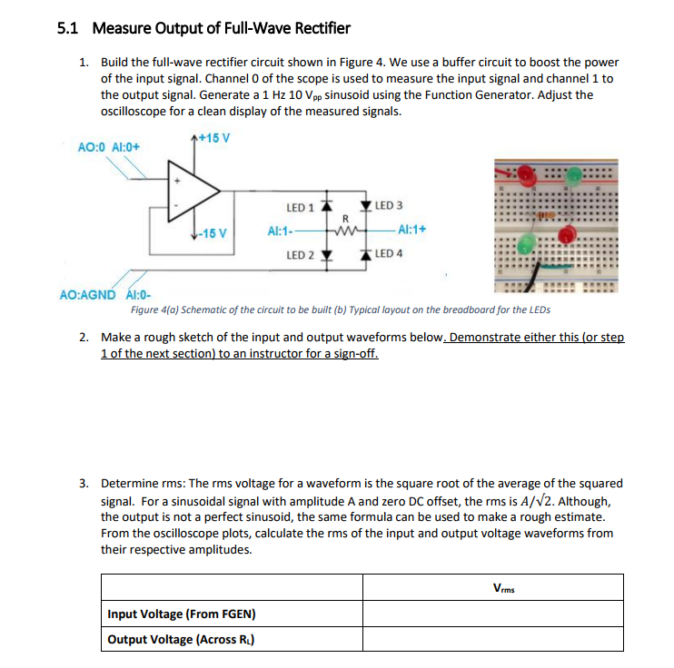

I am trying to solve this lab for circuits class, but for some reason, the myDaq oscilloscope software is not showing the correct sine wave to find the question number 3 or 2 in the following image. The circuit I am trying to solve is also given in the following image with the given settings for the software.

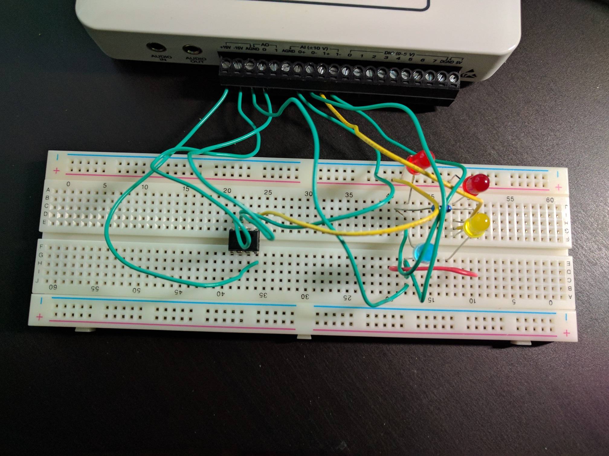

Here is the image of the circuit, I made sure the connections are right almost 10 times now. The op-amp number is - TL082

1. It looks like one connection is missing in your circuit:
Pin 1 and 2 of the IC are not connected as they should be,see below.
2. notice the scope says "waiting for trigger",better put it in type="Auto trigger mode".
3. You should use colors of Leds as shown in the paper.
