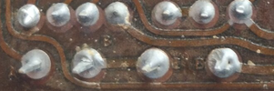

What does IOP on a board mean?

Some solder problems :
Bottom pin 2'ond one in from left.
Top right pin.
Top right 3 pins.
Pics of top of board ?

Reflowed. Found out of spec caps, transistors in backwards, wrong resistors. I didn't have the right time caps... Got close though!

Single-sided and only 25 components. If you know which ends are the input and output, this is not a difficult schematic to reverse. To start, print the bottom side image mirror-image, and start marking up a blown-up image of the top side with traces. To keep the board design single-sided, there are lot of long traces looping around things. Step 2 is to redraw the traces with more straight-line connections to eliminate all of that looping clutter. Now you have something you can transfer to paper. All of that is less than 1 hour.
What are the markings on the transistors?
