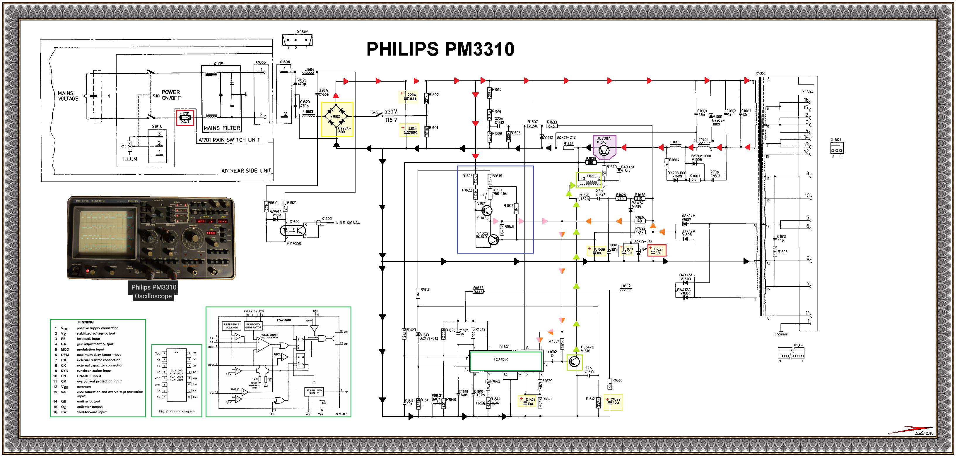

Sir BEripsta . . . . .
Here is a mark up of just the units power supply section.
This unit is a HOT chassis to the AC line of all circuitry, being to the left of the X1604 Switch Mode Power Supply transformer primary.
At schematic, top left, you have the MAIN DC voltage being created by the V1602 FWB YELLOW SQUARE and traveling across to the
#2 primary term of the SM Pwr T-former, passing thru it, and ending up at the collector of the BU208A SM POWER XSTR.
Initially , in a no power condition, see if BU208 is shorted C-E and has blown open its R1627 emitter resistor to the left.
If all is well there, do the powered up voltage testing.
The MAIN DC voltage also branched down above the interlocked pair of V1621-1622 via a RED arrow path and upon power up, there
is a "kick start" voltage that passes down the PINK arrow line , to the pin 1 power input of the SMPS IC TDA1060.
A timed burst of drive pulses are then passed to the base of the V1615 driver transistor which follows the LIME GREEN path to the T1603
driver transformer, which then drives the base of the BU208.
If all is well, the terminals 4-3-5 winding of the power transformer supplies voltage pulses to be rectified and filtered by diodes
V1605-1607 to be establishing a constant power supply by using C1623 (gotta be GOOD !).
Then the ORANGE ARROW path carries that voltage down to the apex of the initially used PINK ARROW path that started up the unit.
with the temporary power to pin #1of the TDA1060.
The unit then runs the TDA1060 on this mentioned ORANGE ARROW path supply.
E-caps that could decline in functional capacitance and shut down the unit could also be YELLOW C1611--C1609 and down in the
TDA1060 proximity . . . . C1621--C1622.
Also check R1613 1 meg resistor for high or open.
POWER SUPPLY PRIMARY MARK-UP . . . . . .
73's de Edd . . . . .
