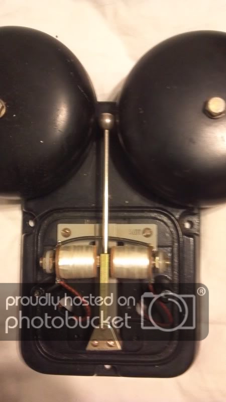

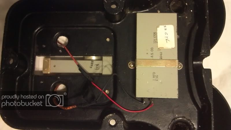

Hi, I recieved what looks like an old school bell from my girl friends father which he wants to get working. I am an electrician however do not know the wiring from this bell. It is a large bell so not sure the voltage? Also, how would i wire this baby up? On the back appears a transformer or capacitor with 2 wires going to the magnets? There are no power wires on it.

looks like a capacitor.
positive and negative supply to red and black wire should do it.
what ever voltage is another thing!!

No. Both wires coming out if the capacitor go to each magnet. Then one black wire goes from one magnet side to the other magnet

that would be supplying power to each coil id say. or else its a common ground wire.

thats my judgement of it anyway. it would be a DC voltage u'd apply i reckon.

Yeah, it appears to simply be two magnets, energize it with some low voltage DC, I would start at 3 and move up to 12 or 18, it's likely not all crucial the higher voltages will just make the frequency higher... The magnets should flip flop as the 'ringer' breaks and makes contact as it moves from side to side...

Tried that many times, but the arm just hits the bell once, does not repeat

It is also a very large bell. The bells are 6" in diameter each, could it take more voltage?

I would not even attempt feeding it 120v, take your battery and pulse the current, aka tap the connection fast... If that works it wants a pulsed DC or AC current...
If your low voltage battery is energizing the coil enough to activate there is no way you need 120v...

Could it be that the hammer is breaking the contact to one magnet and making to the other magnet for driving the other way? The capacitors could be noise reduction or timing elements.
If driven by AC the frequency need to be very low, due to all the weight needed to move.

My guess is it's a telephone bell. If so, it will be designed to run from a 20 Hz sinewave at around 100V. I wouldn't connect it to the mains; the frequency is much too high and it will overheat because the clapper can't move that fast.
