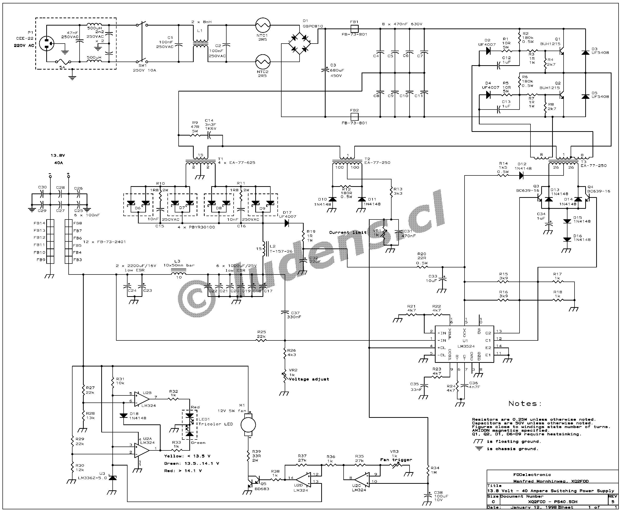

Hi Shahriar,
Maybe the TEA1507 is not the best alternative for you?
Here is an example of a 550W+ of line PSU:
The description is here: http://ludens.cl/Electron/PS40/PS40.html
Even though this circuit has a fixed output voltage I am sure it will give you a good idea of how to build a similar circuit with your own specs. 8)

Dear ANTE
Thank you very much. I had searched the web a whole day, but didn't see the thing you posted? ???
It is very similar to this document I have attached. I have a question In this document:
how much voltage changes can we achieve at the output by varying the voltage divider at the TL494 Err Amplifier Input.
(Suppose that the Over protection circuit is disabled and the secondary Windings have been changed to proper number)

Hi Shahriar,
The ratio of the transformer winding decides the maximum voltage. By adjusting the feedback voltage it might be possible to get the output voltage all the way down to 0Volts.
