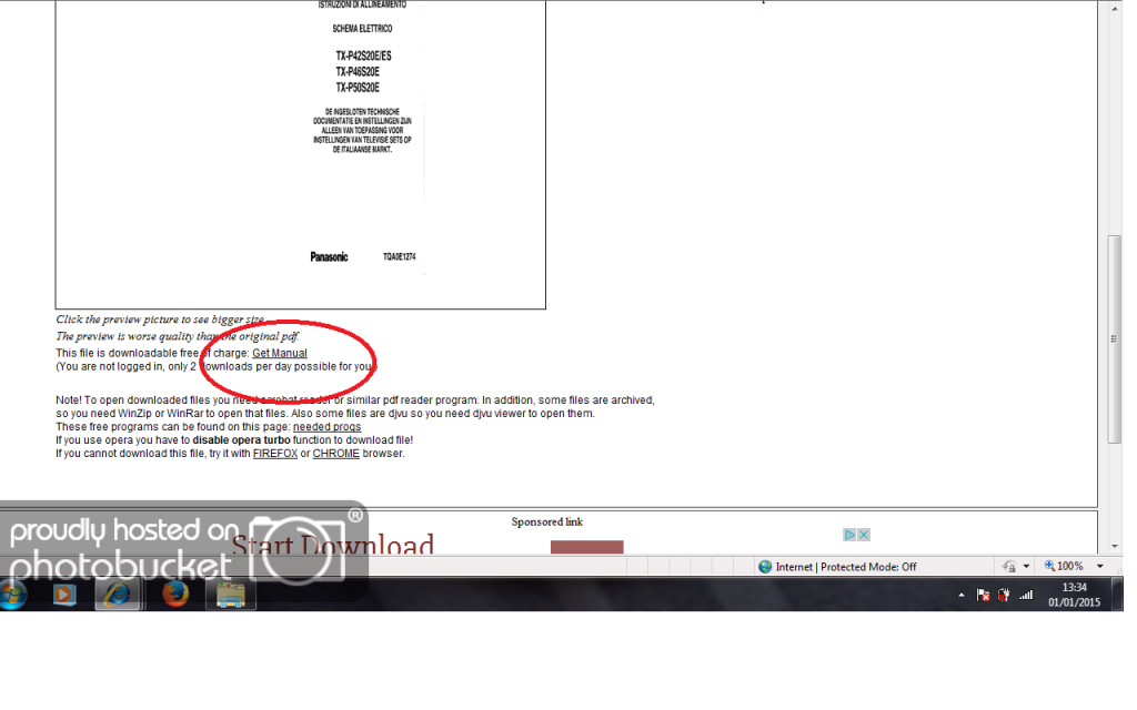

Shal I start with the psu? Also going to try find a schematic,

And ok will look at the psu first.
