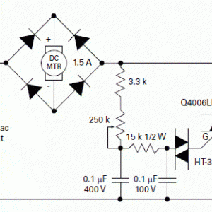

I assembled a PMDC (permanent magnet DC) Motor Controller for use with my variable speed mini lathe.
Forum member "Minder" was extremely helpful with this. Although it's a simple circuit, it can still be confusing for those of us who aren't very experienced with building electronics.
The motor is a 110 VDC (Volt DC) permanent magnet motor, and rated to 250 watts. This should work for any 110-volt DC motor, however, if you adjust the TRIAC and Rectifier to the appropriate amperage.
The original controller is about USD$150 to replace and comes with overload protection, but you can put this controller together for about $15 in a pinch.
Sometimes poverty, not necessity, is the mother of invention :)
You will need:
- TRIAC (I used Q4008L4 [8-amps 400-volts] but you can use whatever can handle your motor's power)
- DIAC (I used NTE6408 but again, others will work)
- Resistors (3.3k ohm resistor, 15k ohm resistor, 100 ohm resistor)
- Potentiometer (Pot) 250k ohm
- Capacitors (I used three 0.15uf 200-volt capacitors... schematic calls for 0.1uf)
- Bridge rectifier (I used KBPC806 [8-amp 600-volt] but any appropriately sized rectifier will work)
Schematic:
What it looks like wired up:
Lines showing the connections on the underside of the board:

There exists mains supply dangers in this arrangement as shown that others should be aware of.

This looks like a very useful circuit for me. I put DC motors on my machine tools, up to 1.5 HP @ 90 VDC. I looked a some software to make a custom PCB and was overwhelmed by the complexity of generating it. So, is there an easier way to make a clean looking board with terminals and mounting holes?
Minder
Apr 24, 2015
3,560
Apr 24, 2015
3,560
For one-off's I use Stripboard Prototyping Boards
Halfway down the page.
Use a 1/8th drill to open a trace, the holes can be opened up to accommodate terminal strip etc.
Use a Box cutter knife to run down between each strip to check for shorted strips that may occur.
There is also strip board software out there to assist in layout etc.
