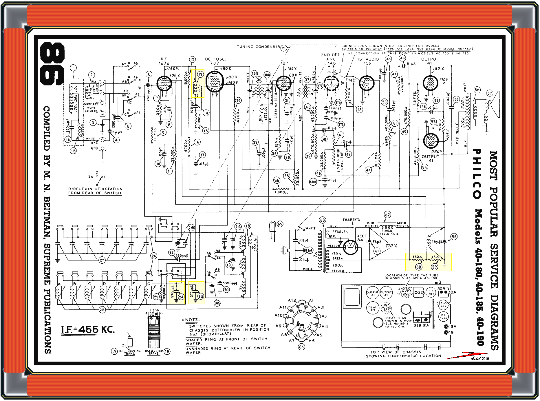

These parts are from a 40-180 console radio that I'm looking to restore. I'm hoping someone on here can tell me what kind of components these are and possibly their values as well.
This looks like a foil capacitor covered in wax, but there are absolutely no markings on it:
Are these two resistors? How do I determine their value? Are they high wattage?
All I can think of here is marshmallow covered in caramel. I'm guessing by the size and the direct connection to ground that it's a high-watt resistor. The only markings show "370 30 1157"

maybe a cap … I first thought an inductor … wire wound on a ceramic former covered in wax
can you scrape off the wax without damaging what is below it ?
yes they are ….. probably not overly high wattage, maybe a few watts
measure them as you would with any other resistor ( multi meter in Ohms …. you may have to disconnect one end to stop rest of circuitry causing false reading
most likely a mica capacitor and 370pF

Best method would be to source the schematic - which is very likely easily available (as below) - and essential for anyone doing restoration work.
The 'wax covered thing' looks to be an inductor - the schematic doesn't give a value but does show it to have a DC resistance of 9.5Ω.
You'll have to show more of the chassis and trace the valve pinouts to determine where the other parts are located.

The resistors could be body, tip dot. I cannot see the dot on the big one but the other could be 15Ω.

Sir Kilgore Cemetery man , . . . . .
Pic 1 is a widely resonant RF choke load in the plate circuitry of the 1st Rf amplifier . . .about 3.5 ohms resistance.
It is identified as Item 13
See if your two olde tyme carbon composition resistors are the ones shown being in series from the 84 rectifier tube to ground.
Marked as items 59 and 60.
There are two 370 pf silver mica associated with the pushburtton tuning assembly . . .Items 24 and 23.
You have a few potted black modules on the unit that will have bad paper caps within them.
1A-B . . . .40 A
To be digged out or heated / warmed up to permit removal of that tar surround potting compound and cap replacements.
They are listed as A-B-C supplements to the normal item numbering scheme.
Upon completion and celebration . . .this little puppy requires 78 candles on its birthday cake . . . .
Le OLDE TYME SCHEMATIQUE . . . . .

The parts are resistors 59 and 60.
The big one is body tip dot but the body and tip are the same so it is not obvious. 150Ω

The voltage drop across the speaker is about 85V so about 80mA.
Power is I*I*R so the 150Ω resistor (#60) will dissipate about 1W. Use a 2W resistor if you have to replace it

The small one has drifted to about 17Ω, and I'm guessing the large one is supposed to be a 150Ω (now closer to 176Ω).
Yes sir! That looks to be correct!
