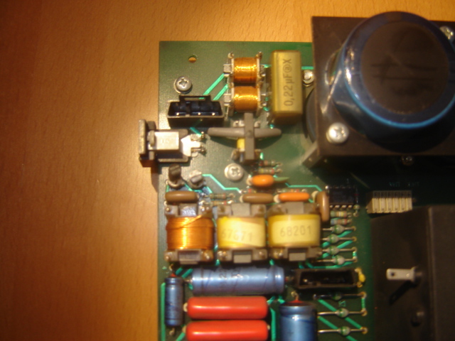

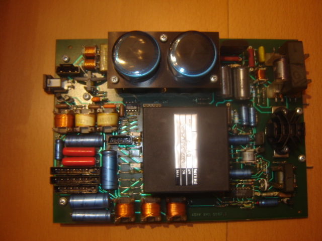

Tough luck.. Was it properly set for the correct mains voltage? Unfortunately the only diagram I found on the web was very small.
Fortunately blown fuse faults are usually the easiest to fix. It's probably the mains rectifier or the main switching transistor that's shorted.
Just provide us with good pictures of the top (& bottom, if easy) of the power supply and we should be able to tell you where to measure.

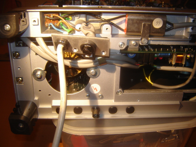

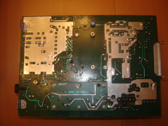

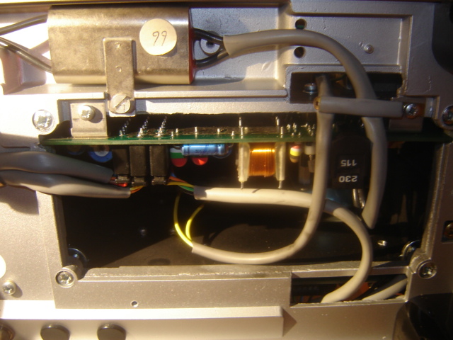

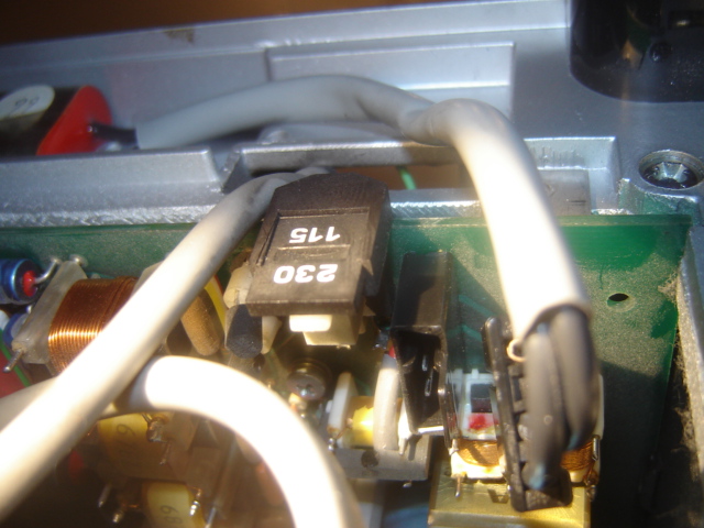

Here are the pictures as requested.
Power into the unit....
Through the mains filter to the power board....
Power board connection...
Power board both sides....
And main power connection onto board...

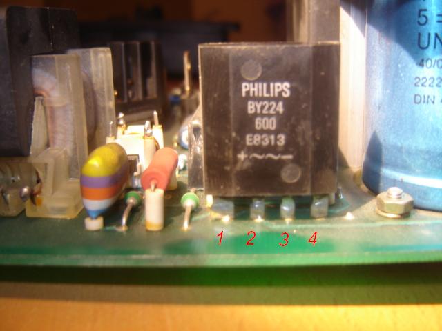

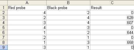

Here are some testing results on the rectifier but the rectifier was still mounted to the board.
Pins 2 and 3 read as 0 both ways
Pins 1 and 4 red 503 and 0 other way round. (because its still mounted to board i suspect.

20m actually means 2 meters, but I guess you meant 20MΩ which means 20 Mega Ohms. It's not the best range to test diodes. Don't you have a diode range?
I don't see anything immediately wrong with the rectifier bridge though. Did you try to measure (or apply power to) the mains cord with the PSU disconnected?
It would be interesting to measure from 1 - 4 too. The pictures are not very bad but they could've been sharper. A resolution up to 840 x 630 is also ok.

Sorry i have modified my results above using the diode setting. The rectifier looks good.

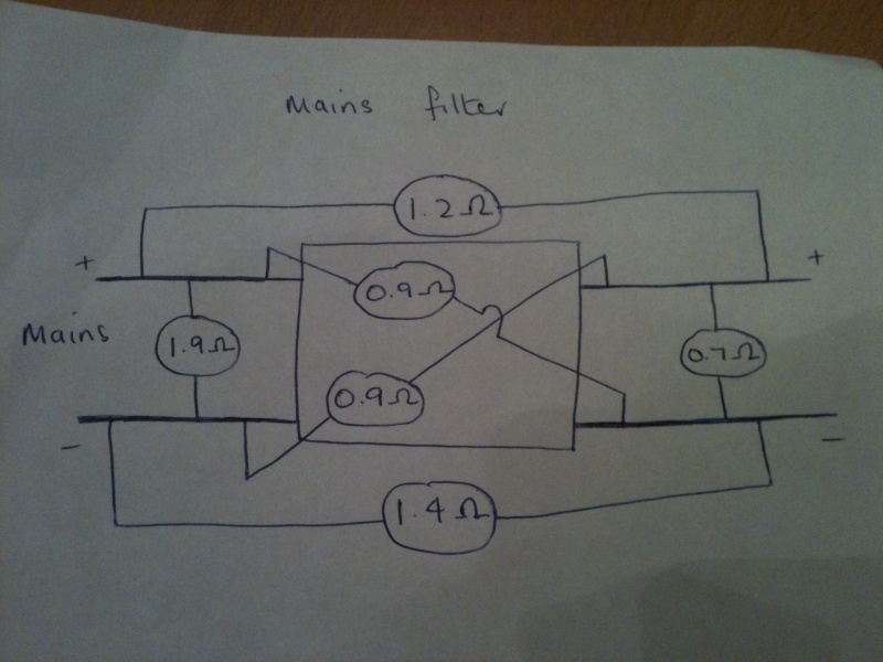

I wish i have some fuses to hand to confirm the short is on the psu and not a board off it. I want to totally isolate it. Anyways i did measure across + and - of the rectifier but only in circuit. With red probe to + and black to - i get nothing and other way round i get 508Ω. Here is the meaurements across the mains filter.

Well, there's your short right there, there's nothing more to test, try, or measure. Just replace the mains filter, or bypass it.
Is it safe to bypass? I won't damage anything else? I have to find a replacement now. :rolleyes:
Resqueline
Jul 31, 2009
2,848
Jul 31, 2009
2,848
Electrically it's safe to remove & bypass it, but from an EMC standpoint it may not be considered so ok as the 'scope may emit some more noise onto the mains.
There remains some filtering on the PSU itself though. You can replace it with just about any mains filter unit you can fit in there if you want to.
