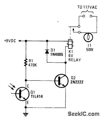

One problem will be that if you use a small battery to power an electromagnet, the battery will run out way before darkness falls.
Another problem is that a light dependent resistor can't be used to switch power the way you suggest.
What you need to do is have some form of momentary action to release the door. Perhaps you could use a solenoid to open a latch?
You will also need to consider what level of darkness is dark, and how you will stop the device from repeatedly triggering all night.

Try this one, but substitute the relay coil with a door latch.
This door latch is rated at 9VDC.
http://www.adafruit.com/products/1512?gclid=CJHkxY6u0MQCFdgDgQod8VoAYw
Add a limit switch inside the door wired Normal Closed to turn off power to the circuit when the door closes.

Sorry, trying to make it simple yet effective. If you see something that's not right let me know.

Just an update. We abandoned the electromagnet idea. We ended up using an door lock actuary out of an old Suburban, The actuator held the chicken door up. It was wired to a 12 volt timer then to a car battery. When the time opened the flow of electricity, the actuator fired and pulled back allowing the door to slam shut and latch using a cabinet latch. It was very simple and accomplished the task beautifully. Thanks for all your input!
