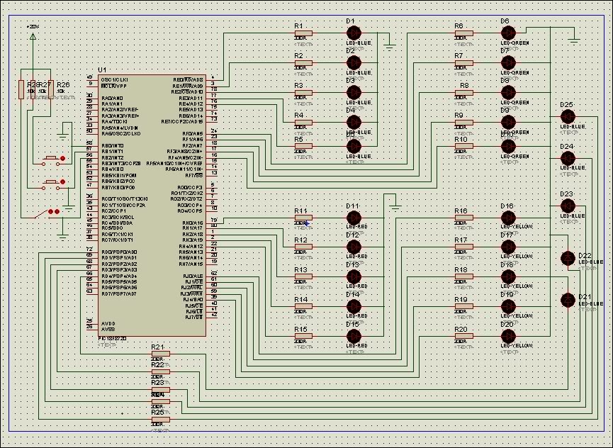

Hi. I'm new to assembly language.I'm doing running light using 25 leds and pic18f8720. Testing on proteus. I'm unable to make it work.
Kindly see the attached source code and proteus dsn file. Hope some one can correct my mistakes here.
Source asm, hex and dsn files here:
http://www.4shared.com/file/mXSlyfpo/Project_mplab.html
Thank you.

I doubt that anyone is going to replicate your layout and attempt to debug it.
Perhaps you can tell us what it is supposed to do, what it does do, and what it doesn't do.
