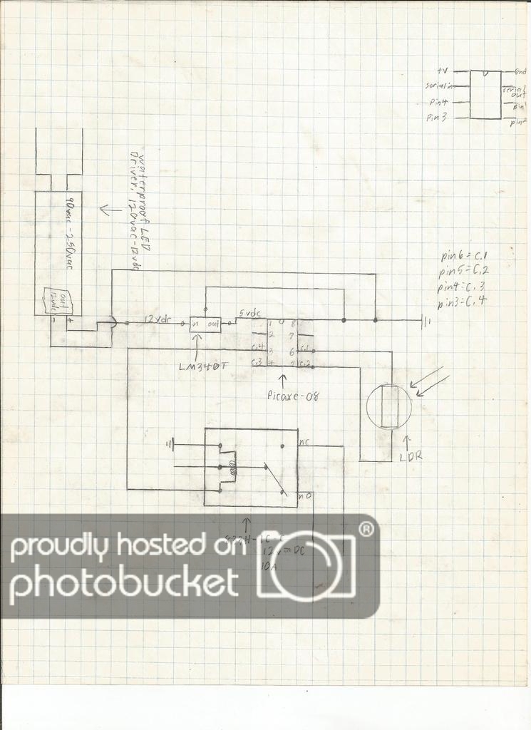

Ive drawn out a schematic of what I'm building and need some help
Basically I need C.1 to always be high.
Between C.1 and C.2 will be a LDR sensor. A laser will always be pointing at this.
When the light in broken it should set C.2 as a high.
When C.2 is high I need it to activate C.4 as a high which will turn a relay on for about 15 seconds.
After 15 seconds, I need it to make C.4 and C.2 as a low again which will turn off the relay and start over again.
This is how far I somewhat got...

So I have a project I am trying to build but still learning about the Picaxe software programming.
I am just getting into programming and someone had pointed me to this Picaxe IC chip for my project.
Theres alot to learn about it obviously but needing alot of help
I attempted to start to write some of the programming which sort of works but not really ha
That makes little sense. If it's "always" high what's the point of wasting a uC pin to do it? In logic if a node is always high you just tie it to the 5V rail. This does not mean that you should tie C.1 to +5V though.
This makes no sense either. You only need one pin for LDR input. When using LDRs you need to input it as analog, IE:
Code:
ReadAdc 2,B1
. Which translates to "Read Analog Value On Port C.2 and store it in the Variable Name B1". I don't think you spent enough time reading the help files. They describe typical LDR input and supply sample code.
No, this code needs a lot of help. Read the pdf files.
main:
high b.1
if input2 = 1 then high 4 endif
if input2 = 0 then low 4 endif
LDR:
wait 3
if input4 = 1 then low 4 low 2 endif
goto main
Again, the help files will show proper relay interface. You have no protection diode across the coil.

Well I didn't think about that. That I could just tie the LDR to the source voltage. So then basically I just need 1 lead of the LDR connecting to pin 1 so when the beam is broken it can turn on a 2nd pin triggering the relay.
I haven't been reading any pdf files. Ive been trying to watch the youtube clips on programming the Picaxe and also reading the Picaxe manual.

I think I also got the LDR backwards. I always thought that these photocells use light to block the current but the light actually allows the current to pass.
That being said, i think I came up with a code and it seems to work. Let me know what ya think.
Code:
main:
    if input1 = 0 then high 2 endif
    if input1 = 1 then goto main
LDR:
    high c.2
    wait 5
    if input2 = 1 then low 2 high 1 endif
    reset
It seems to work.
Except when blocking the LDR it doesn't do anything. My LDR holds at 5.07v when not blocked. When I block it the value changes to 4.65v i do believe. I think I found a code to use this that will watch for the values so that if it goes below 5v that it will turn on pin 2. Its the INPUTTYPE mask code.

LDRs are not a good choice for digital inputs. They're generally used with a Picaxe by using an ADC ("A"nalog to "D"igital "C"onverter) pin. Hover your mouse over each pin (Tool Tips) of the 08M2 image and you will see which pins accept ADC input. Typical code and circuitry is found in both manual1 & 2. Read up on the ReadAdc command.

I told you more than once that LDRs are NOT digital devices. They're ANALOG! Did you lookup the ReadAdc command?
I will make a deal with you. If you agree to loose the LDR and replace it with a PhotoTransistor I will draw the circuit and write the code for you.
What say you?

I ran your code and was shocked that it didn't throw multiple errors. I can tell you this though. Placing multiple commands on a single line is not good programming SOP. It will make debugging longer programs harder to read and harder to fix. It will also inhibit the simulator's ability to pause over each command. In most other languages this practice would be rejected by the programming editor with only few exceptions.
I consider this OK because the program branches to another code block as soon as it's executed and is one of the few instances that EndIf isn't required.
Code:
If PinC.1 = 1 Then GoTo main
This structure, on the other hand, should be avoided.
Code:
If PinC.1 = 0 Then High 2 GoTo LDR EndIf
Also note that in both examples I changed your "Input" command to "PinC.1". This is because you're using "Input" for something it wasn't intended to do. Why the editor doesn't upchuck on it I don't know. I suggest that you read up on the Input command more thoroughly.
Regarding LDRs:
Microcontroller Inputs treat LDRs the same way they treat Potentiometers, Variable Resistors (Rheostats), Thermistors, or just about any device that produces an Analog voltage. These devices are never simply logic 0 or logic 1. The ReadAdc command reads discrete voltage levels broken down into 255 parts and stores each value measured in a Variable. You then tell your program do something when the Variable's value is equal to (=), higher than (>), lower than (<), not equal to (<>) or unchanged from a value you specify or even another variable that changes value somewhere else in your program.
This block of ReadAdc code was taken from Manual 2 (Basic Commands). In plain English it says "Test the Analog Voltage on PinC.1. Divide the chip's supply voltage (5V) into 255 parts and store the value in the Variable B1. If the value of B1 is greater (>) than 50 Then Go To the flsh block and execute the code there. When finished executing the flsh code go back to main. On the other hand ..If the value in B1 is not greater (<) than 50 Then Go To main instead and keep testing B1 until it's greater than 50.
Code:
main:
readadc C.1,b1 ; read value into b1
if b1 > 50 then flsh ; jump to flsh if b1 > 50
goto main ; else loop back to start
flsh:
high B.1 ; switch on output B.1
pause 5000 ; wait 5 seconds
low B.1 ; switch off output B.1
goto main ; loop back to start
I would be remiss if I didn't tell you that the simulator provides for simulating the ReadAdc command by providing you with a Values panel that you can enter the C.1 value. Look in the lower left corner of this screenshot to see this panel. In your case this panel is mimicking an LDR connected to PinC.1 input. I set the value to be 38, which is less than the required 50, so the program never jumps to flsh:. Also look up in the right hand corner to see the current value of B1. You'll see that it's what I set the ADC (C.1) value too.
Use the Up-Down scroll bar arrows to increase the LDR value to 50 and see what the program does. Then change it to 51 and you will see the program jump to the flsh block.
This panel is designed to be interactive, so you can change the C.1 value while the program is simulating.
Have FUN!
Chris
