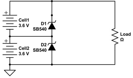

Battery:
I am using a battery pack for my project that has SB540, Schottky rectifier, connected across the battery cells' poles. This is to protect against reverse polarity connection, I assume.
The battery pack consists of two primary cells, Tadiran SL-2780, connected in series (7.2V output). Each cell has its own diode. Therefore, two diodes exist in battery pack. Battery chemistry is lithium thionyl chloride inorganic electrolyte.
What is the question?
My project is running very low on power as mostly it is in deep sleep mode and consumes about 7uA.
Q1. Considering this little consumption, and the chance of connecting the battery in wrong polarity is almost zero, is it a good idea to remove the diodes to prolong battery lifetime?
Q2. Do diodes, in this configuration, use energy and dissipate as heat? (we know that ideal theories do not apply in reality and all diodes have leakage in reverse.) I would like to prevent any energy loss, even small ones in uA range.

Welcome to EP!
The diodes are there to prevent the cell with the lowest capacity getting charged 'backwards' in the event that the battery is drained excessively. Removing them would not be a good idea.

You may really have an issue there. Attached excerpt from the data sheet. The SB540 is a 40 volt part, so you are operating it at about 9% of ratings. At 25°C, the leakage is around 6-7 uA. At elevated temperatures, it gets worse. If it is possible to change the diodes, you could probably find some with lower leakage. But as others have said, total removal of the diodes is not a good idea.

Alec_t, could you please elaborate on it? How is it going to prevent a cell from being discharged in backwards?
Perhaps this simulation will explain. Two cells each initially at +3.7V are simulated by capacitors, with C1(C3) having greater capacitance than C2(C4), so C2(C4) represents the weaker cell. Without the diodes, C2 discharges from +3.7V down to a damaging reverse voltage of -1.2V. With the diodes the reverse voltage of C4 is limited (by the forward drop of a Schottky diode) to a non-damaging -0.3V.
