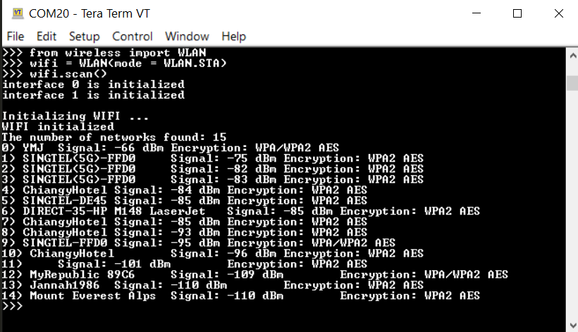

Ameba RTL8722 is an ARM Cortex-M33 microcontroller that has dual-band WiFi and BLE 5.0, other than that it is fully capable of running MicroPython and controls WiFi using Python script. In addition, its requirement for developing platform is also quite minimal-- only needs a serial port terminal like Tera term. Here is an example of RTL8722 controlling WiFi using just a few lines of Python code on Tera Term,
from wireless import WLAN
wifi = WLAN(mode = WLAN.STA)
wifi.scan()
Right after the last line, you will be able to see the result printed on the Tera term almost immediately,
