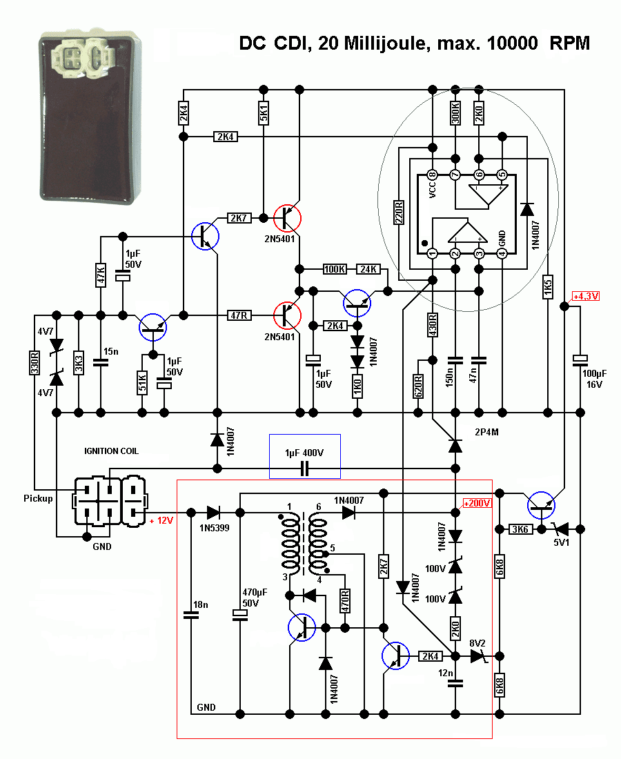

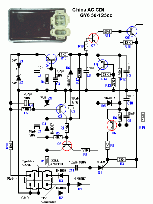

I found this:
and this:
There is no microcontroller in those units, is this normal? is this some kind of analog advance/retard circuit?
The unit you see in the higher half of the lower schematic is the HV inverter for charging the high voltage capacitor
Those DC units are 8 dollars so that is not the point but it will take a month before I can even start I think and it will be winter soon :mad:

I don't see an advance retard circuit circuit for ignition timing. What I do see is that, in the lower schematic, when the pickup coil puts out a positive voltage two unpacked transistors turn on causing the operational amplifier output to go positive causing the SCR to turn ON placing about -200 volts into the primary of the ignition coil and at the same time turning off the 200 volt charging circuit for the capacitor so that the SCR can turn off. The 12 nf capacitor will keep this circuit off for several microseconds so that the 1 uf capacitor can finish discharging so that the SCR can turn OFF.
I don't see any need for a micro controller in this circuit so I assume this is normal.
Frankly I have no experience with this type of ignition system so maybe someone else will no better.
