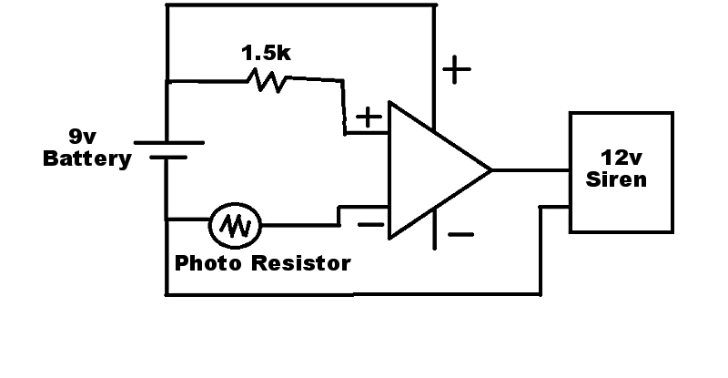

Here is my attempt at a block diagram for my circuit... i hope i have everything covered... But i know im doing something wrong, otherwise i would have 9v or close to there on my output side. This circuit is mainly a test circuit for another project i am working on... I hope to use this and add it to a solenoid instead of a siren... but that is neither here nor there right now.

Firstly, the comparator is unlikely to work in this case.
1) you need to source current in this configuration and the comparator can only sink it.
2) the comparator is unlikely to be able to sink enough current to power the siren
3) your circuit is going to have the siren on all the time no matter what the light level is.
4) the 12V siren may not work from 9V.
So, what do you actually want?
Do you want the siren to go off when the light level exceeds a certain level, or when it gets below some level?
Also, can you describe the siren in more detail?

The comparator can work with inputs down to the negative line but I see no information as to how high they can go. I suspect that you are trying to run the inputs outside their range.
The inputs should be a bridge so that one input is at half the battery voltage (use two equal resistors) and the other input with a resistor in series with the LDR. The output will change at the point where the resistor and LDR are equal.
The pull up resistor must be low enough to provide a current for the load and high enough to be within the capability of the comparator.

And, you will need a transistor switch to turn the siren on and off. The comparator cannot do this alone.

As of right now, the siren makes very low but audible noise, and when i shine the light on the photoresistor it turns off... The purpose of thise circuit is to cause the siren to go off, even if it is only a chirp, when someone walks through the beam. The siren is a 12vdc Piezo Buzzer, 7-14vdc, 150ma, 108db.
If this circuit will not work, can you suggest a different one that may? Also will this circuit work for activating a solenoid, for a brief second or two? The solenoid in the second circuit im working on is being used as a latching device. Break the beam the solenoid activates and pulls the pin releasing the spring mechanism.

No, the maximum output current from the comparator is in the order of a couple of mA, totally insufficient for the "siren" or a solenoid. (It's actually 16mA -- see here)
As Bob suggested, a simple transistor will allow this to work.
With appropriate googling, you can find circuits that use an LM339 to switch relays etc. They will show the correct wiring.
If you find the siren is on when it should be off and vice versa, simply swap the inputs to the comparator :)
If you don't want to use a relay (for your siren perhaps) then place it here the relay coil is shown.
