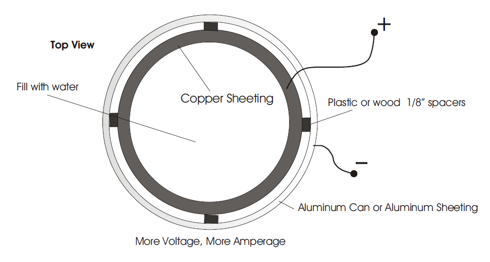

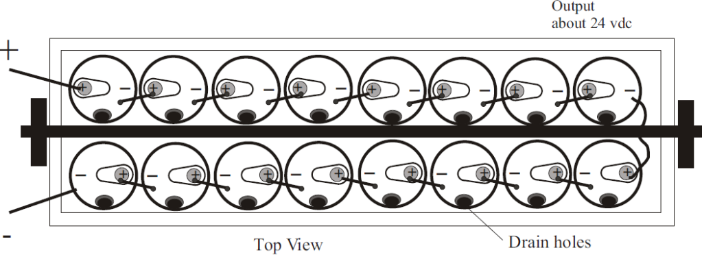

Hello!
As you can see in the above photo, I am making/planning a series circuit of aluminum can batteries. The copper sheeting inside (second photo) is the anode and the aluminum can is the cathode. My question is, I will connect the negative to positive terminals (series ) from one can to another using a copper wire. Will this affect the current? Because, as I have read, the aluminum and copper in my battery should not touch but the copper wire will be touching the aluminum can. I don't know about all of this so please help me. :)

your statement on your lower diagram about more voltage more current is not an accurate one
for example say your 16 cells in the top diagram are 1V each then, you have 16V at a given current capability when they are in series as shown.
If instead, you parallel all 16 cells then you have 1V at 16 x the current capability
Dave

I understand that part. Thank you for clarifying that. Umm.. But can you answer this question I posted above?

You have to differentiate between alu/copper within the electrolytic cell (aka battery) and the alu/copper connection outside of the cell.
If the alu touches copper within the cell, this short circuits the cell and the cell voltage will drop to 0V. So in this repect, as you correctly stated, alu shall never touch copper.
Outside of the cell there is no electrolytic process, so no voltage generated. Therefore you can use and conductive material to connect two cells. That includes copper.
Harald

I have another question though, if you don't mind. It's just that I would like to know what two metals would create the highest voltage if placed in an electrochemical cell. Also, does the distance of the two metals create a significant difference. For example, what if they were closer? I know there are limits, so to what extent or distance can I put them away from each other (minimum and maximum)?
If you have an idea, please tell me. This is for my science fair project. I'm 14 :)

The cell voltage depends on the difference of the "standard electrode potential" of the two metals. See here http://hyperphysics.phy-astr.gsu.edu/HBASE/Chemical/electrochem.html#c1 or in the wikipedia.
The distance between the metals plays a role insofar as (in general) the electrolyte conducts electric current not as good as a metal. Therefore it poses a resistance to the current.
As long as the cell is unloaded (no current), you won't see a difference. The cell voltage will be the same if the electrodes are spaced close or far apart. If you load the cell (draw power from it), then the voltage of the cell with electrodes spaced far apart will drop significantly.
You can observe this effect with commercial cells (e.g. AA alkaline battery) when its power has mostly expired. Measure the voltage of the unloaded cell with a voltmeter and you will still find a reading near 1.3V-1.5V. Add a load (e.g. a lamp) and the voltage will drop below 1V.
The minimum distance is practically given by the requirements
1) the electrolyte must fit between the two electrodes
2) the two electrodes may not touch
plus a certain add on for safety (remember that the electrodes will move due to movement of the cell, thermal expansion or contraction etc. Commercially a separator (see http://en.wikipedia.org/wiki/Alkaline_battery) is used to keep the electrodes at distance. You might try a sheet of blotting paper.
The maximum distance is given by
1) the size of the cell
2) the resistance of the electrolyte
Oh, and by the way: water alone is not a good electrolyte for your cells as it is barely electrically conducting. You'll need an additive, typically an acidic one. A simple, inexpensive and not dangerous additive is plain table salt.
Harald
