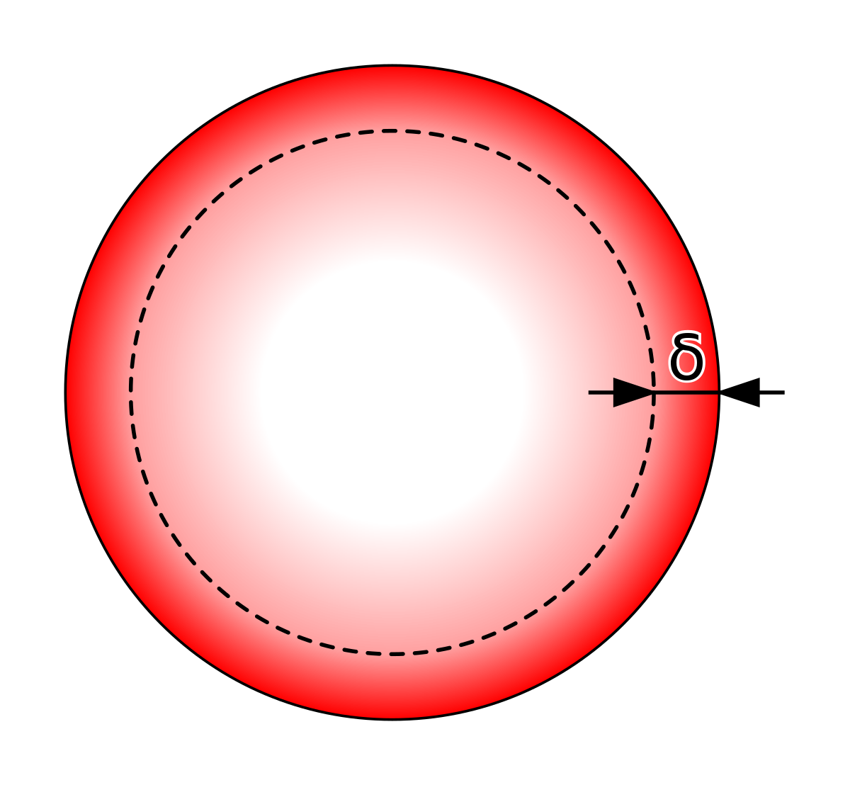

Somebody told me that DC current only flows through the outside edge of a wire. So when you have multiple strands it carries more current. He said if that wire were one solid wire it would carry less current. Is this true?

Believe it or not the simple question you ask is application specific. Even though you have narrowed your question down to only DC ampacity of a conductor stranded versus solid while mentioning the outside edge of a wire.
One may also think that a given length of solid copper wire has a measurable resistance . Therefore if you lay the same given length of solid copper wire in parallel and connect the ends that resistance would be cut in half allowing more current to propagate along the entire length of the conductor because of less resistance . If you noticed I never said current flow and or "current caring capability" ...Cuz you must dive into the world about the physics of conductors and insulators which is beyond the scope of this site. So do you have a specific application in mind?

Okay thank you for all the replies. The application is a 12 volt auto battery powering a 4000 Watt inverter. The length of the power wire is about 4 ft and it's 1/0 or 0/1 gauge however you write it.

What you need to be concerned about with lv is the voltage drop over the cable length and whether or not your connections are up to the job (also points of voltage drop).

Yes, I know. I think my connections are just fine the only thing I can do better is put a second battery with a battery isolator right next to the inverter.
The reason I asked this question is just out of curiosity. To find out if what I was told was true or not.
Post number 7 nailed it!
I just can't help but to add...
The way it was told to you is incorrect but again @crutschow
Nailed it!
