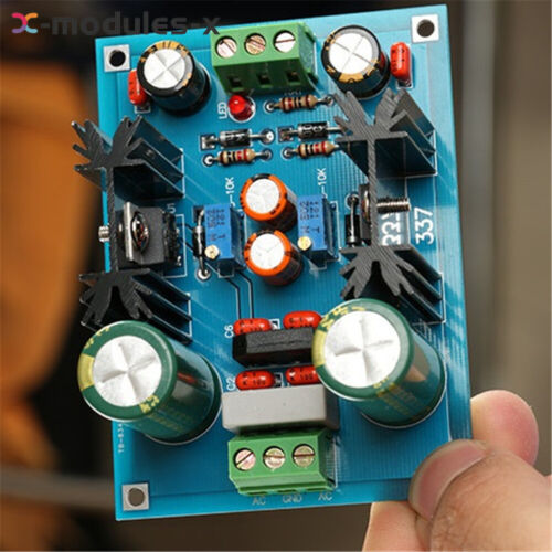

I think the C load on output a major issue (this with just 1u each C) :
I think an OpAmp that can handle C load good measure to carry out.
Dont know if you have seen these :
The above have short circuit and thermal overload protection, which your approach has none of these capabilities.
Regards, Dana.
