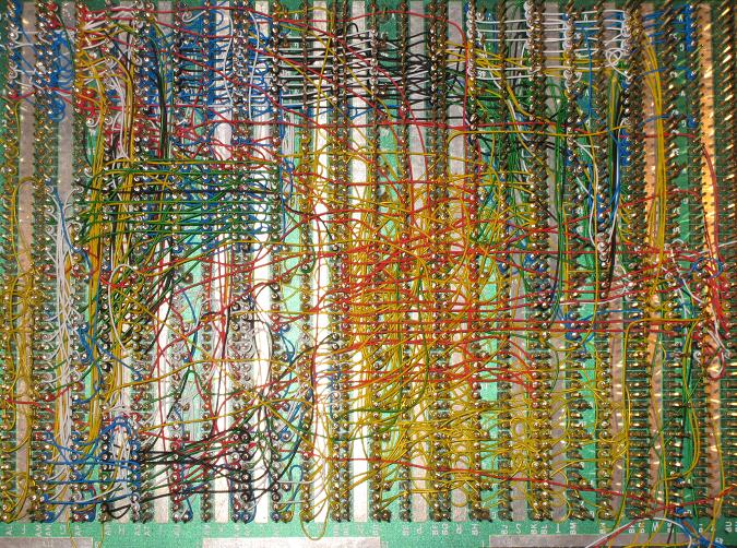

Hello Artronix, I can try and give you a hand with your PLC problems. I am a bit confused with your terminology, but before we get into your problem, here is some general PLC knowledge to get you started.
A PLC is a Programmable Logic Controller. It was developed in 1969 for General Motors. The PLC mimics relays and is configurable/reprogrammable. Before the PLC, when their was a change to a production line, electricians would have to rewire a rats nest of relays and switches.
