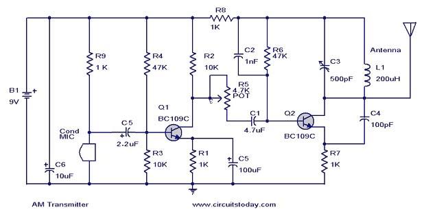

What's the difference on transmitting in lower frequencies from higher ones?
Since I was looking forward to doing myself the whole circuit, instead of buying the transmitter already built, a kind of AM transmitter I found was this:
What are the "modules" within this circuit, as in, what do the different parts do? I was hoping to understand the reasons behind it.
The thing is I would like to transmit within a distance of several kilometers, if that is possible and recieve the signal as "listenable" as possible.

Hi You have to be careful doing your own circuit. It will have to comply with a standard to make sure you are not transmitting out of band and that the RF power isn't greater than is allowed by the ISM band you choose. I personally would buy an off the shelf module.
then you will need a higher power transmitter and it will need to be tested for type approval and licenced
this will cost you lots of money.
If you decide not to get the testing done by an approved testing company, then get it licenced
and just put you product on the air then you leave yourself open to prosecution, which could cost you
everything you own, when you start interfering with legal transmitter / receiver systems
One of the things I look forward to if this projects gets somewhere this Christmas is to implement a better version, along with a receiver, to take with me when I go hiking to the mountains with my friends and maybe cover a range of 1-2km. Maybe it's not even viable. I'm doing my research :rolleyes:
Do it properly and legally
use citizens band (CB) radio ( or what ever it's called in Spain or learn for your amateur radio licence
with which you can then build your own gear legally
