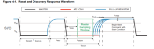

I am trying to use the AT21CS01 Chip from the microchip. It's a single-wire memory chip. I am using it for the identification of my device. I am trying to read the data using an Arduino board. Please let me know how to use that chip.

I have tried all the things that I could. I tried most of the things available on the internet. While referring data sheet, the EEPROM has to drive the S/O pin to low after sending the reset command. But that's not happening. This is the waveform of the same. Please help me store and retrieve data from that EEPROM.

You need to post your code. What Arduino board are you using. How are you wiring
uop the EEPROM to the board, a schematic......
Help the forum help you with basic info....

1. Show us a schematic of your circuit.
2. Show us the relevant code section.
I am driving the S/O pin to 0v for T reset time
After that, you need to change the pin from output to input. Otherwise it will continue to drive the line High regardless of what the AT21 tries to do.
