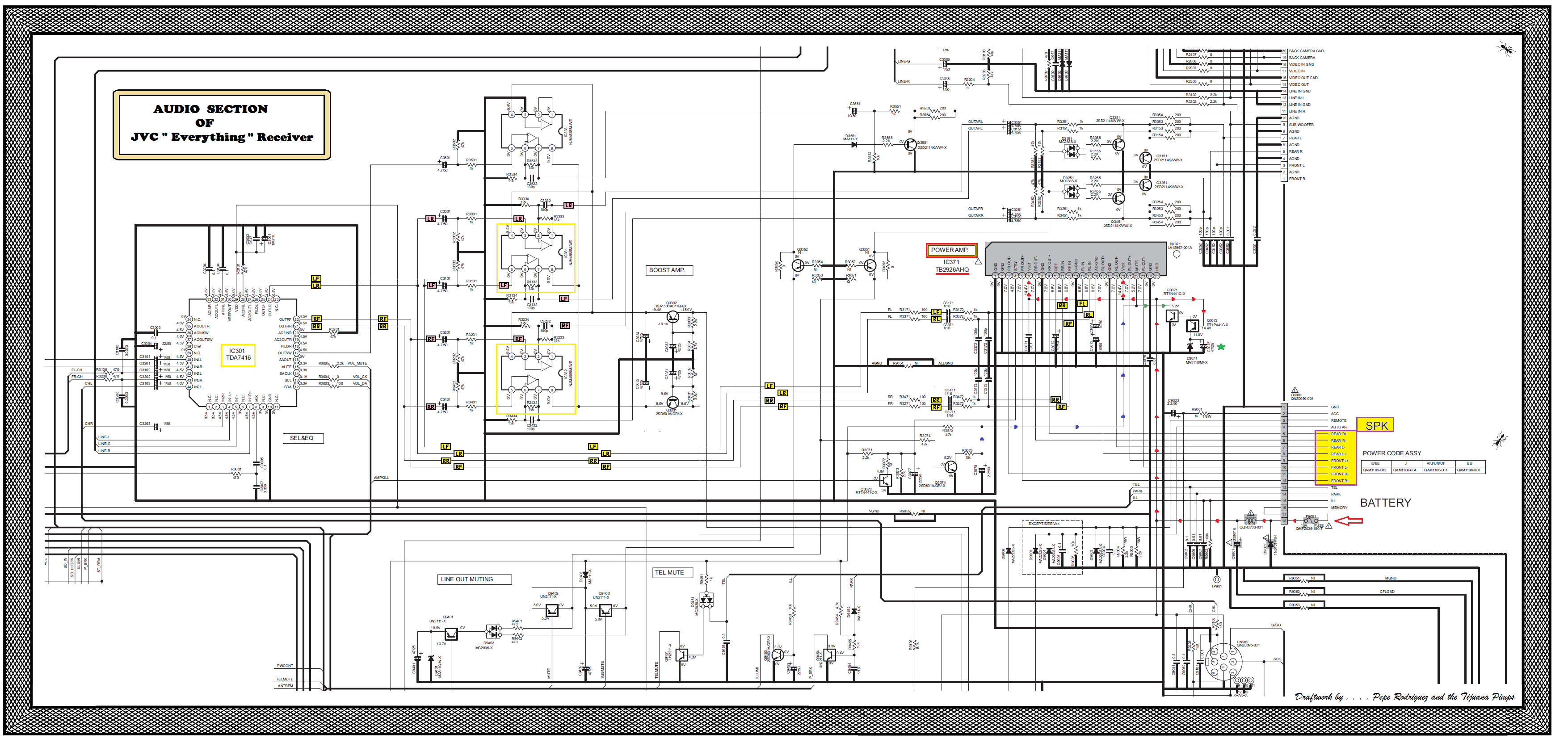

Sir Fuzzzzzzzzysig . . . . . . . . . .
Submitted herewith . . . . . is all of the info that I think will be needed in the troubleshooting / analysis of this units audio power problem(s)
CIRCUIT AND COMPONENT FAMILIARIZATION . . . . .
All of the units audio magic and hocus pocus initiates at the far left TDA4416 chip, where the audio input selections , volume control, tone control functions, Stereo balance Front to Back sound distribution, etc are shifted by control menu input.
Four separate audio sources, leave out of the TDA4416 chip's Pins 24-25-22-21, and route over to the right as being the units RIGHT FRONT--- LEFT FRONT --- RIGHT REAR and LEFT REAR audio outputs, they are flagged at occasional points, as they pass across the page to the right, using BLACK / YELLOW BOXES.
INITIAL ANALYSIS AND TROUBLESHOOTING . . . . .
I had already given you info as to the initial troubleshooting of the 12 VDC main power path into the power module via an ohmmic testing path, but looks like you need to put a fresh battery into your meter.
This time, by the use of voltage measurements, the 12 VDC input starts at the red arrow and flows across the mini "RED arrow path" until it reaches the large toroidal donut and then the large electrolytic and finally passes up the foil path to IC371's two power sector inputs of pins 20 and 6.
In real time operation, that 12VDC supply line ALSO branches to the right to activate digital transistors Q3071 and Q3072 that slams pin 22 of the AF POWER IC into MUTE mode, via the GREEN ARROW path, passing thru the C-E path of Q3071 to ground.
By use of that procedure, the receiver will not exhibit speaker "pops /or / plops" on initial turn on .
Upon the GREEN STAR designated C3075 having accumulated its initial charge, the system then rapidly reverts from being in mute mode and is then ready to make music.
CONSIDERING that there is being no further MUTE / audio over ride demand made via the BLUE ARROW path that feeds down and back to the units Line out and Phone circuitry,
(IF . . . . . those functions even have anything plugged into them.)
( FIO . . .the PINK / BLACK markups are for a line output path, IF ever being needing referencing later on.)
Looks like our testing will be on the sets LEVEL 1 PCB.
The first thing to test is if the 12 VDC power is being present at pins 6 and 20 of the AF power module IC371.
