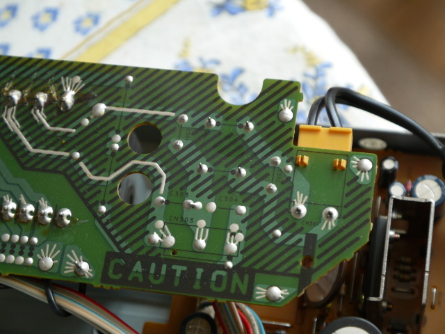

I have a sony minidisc deck coming from Japan. It uses 100 V voltage (Japan one). I live in France so I usually use it with 220 V voltage, using a power transformer. This works fine.
Recently, unfortunately, my son plugged it directly on the wall, so directly on 220V. As you can imagine, it is not working anymore !
I opened it to see if there is some kind of obvious fuse that could have melted or something obvious. I could not see anything clear.
I must add that I am not at all a specialist of electronics, and by far. Another way to say is that I know nothing here ! Just the basics from back when I was a student...
I have taken some pictures of the inside if this can help. Here they are :

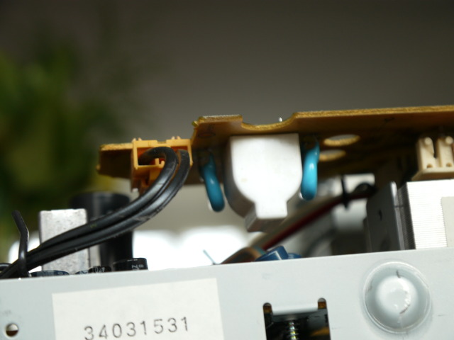

This first one shows where the power cable plugs it into a circuit board (black cable):
There seems to be 2 blue components under (capacitors ???) and 1 white one in the middle (???).

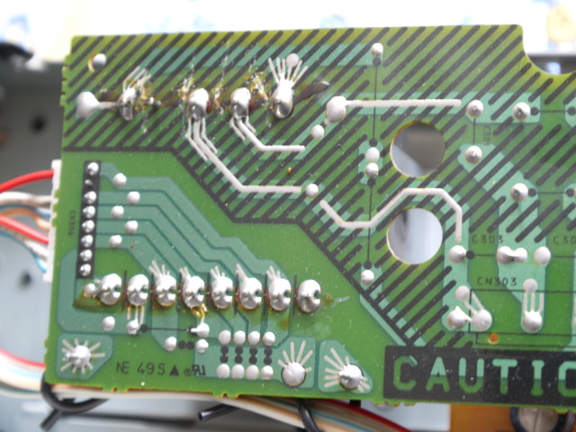

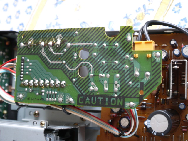

Here is as see from above, the circuit board with the input (right) and output on the left or so I think:

Nice photos, but can you give us one of the top side of the board.
The problem is almost certainly going to be on the part of the board that has the caution hashing over it. The key candidates are a mosfet, a rectifier or a capacitor (in that order). If a fuse has blown, it's almost certainly an indication that one of these has failed.
Bridge rectifiers and mosfets generally fail short circuit unless they've blown themselves apart. A failed capacitor in this case is likely to be physically damaged (bulging, leaking, or blown apart).

By top side, you mean he other side, the one with the components? If this is the case, I cannot access it as it is still mounted, and it is facing down to the box of the minidisc desk.
Someone mentioned that there might be a "thermal fuse" in the power converter and that this fuse might be blown, but that I'd have to unmount and open the power converter to check this... which I don't know how to do.
Does this sound like a possibility to you?
Do you I have to unmount the circuit board to take pictures of the "top side" (which for me is the down side)?

yes the transformer is likely to have a thermal fuse in it, you can just see the corner of the transformer on the right side of the first pic
With the power disconnected, and your multimeter in Ohms mode, check for continuity between the 2 pins of that orange connector.
You should see continuity measuring maybe 1000 Ohms ( the resistance of the primary of the transformer)

OK now just to confirm that its the transformer thats open circuit
go across the 2 centre pins of the transformer primary as seen in pic 4
thats the 2 pins that have tinned traces leading down at an angle and away to the right
if its open circuit there, then the transformer is faulty and you would need a replacement.

thanks for your input. It is actually open circuit between the 2 pins that you mentioned.

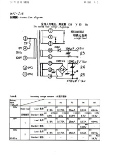

I am reopening this topic after 4 years as I finally got the technical drawings from Sony showing the inputs and outputs of this power transformer. Would anyone be able to help me rebuild it, or to rebuild it for me, from these drawings?

Post the information you have, and let's see! (we've all been waiting :))

Hmmm, it doesn't seem to want to give it to me.
