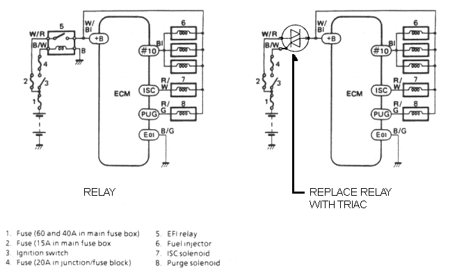

Is it possible to replace the relay with TRIAC for more reliability and silent? Or is there better electronic that can simply turn off and on?
For example... my car has relay so can TRIAC replaces it?
Thanks again!

Sir CMA . . . . .
Considering the infrequent switching needs . . . . ON when the car is running and OFF when the car is not being used.
Along with:
  • The milliohms of contact resistance of a mechanical relays contacts.
  • Not having to worry about the “ trash “ being fed into the gate of a TRIAC.
  • The extremes of the environmental swings under the hood, that this would be subjected to.
I will still take the car manufacturers selection of a type approved auto relay that has been subjected to exhaustive testing and probably prior experience of the unit having proven its reliability, in prior same applications by that car manufacturer.
If this relay application actually involved actual repetitive switching on and off functions . . .tens . . . hundreds . . . thousands of times, that TRIAC utilization might then start to shine.
73’s de Edd

Besides, the important points that Ed gave you there must be a means of turning a Triac or SCR off. They don't turn off when gate current (your Gate switch) is cut off.

Triacs are used in AC light dimmers. Mosfets are used as DC switches in modern cars. Relays were used in old cars.

A triac is usually used with AC but will work with DC (but then half of it is not used). An SCR is the half of a triac that can be used with DC.
A Mosfet is a powerful transistor used with DC.

I car has an electrial system with large currents and long inductive wires. Any disturbance to the steady state will generate voltages in all sorts of places. This is colloquialy called trash. A MOSFET is very sensitive to voltages at the gate so funny things can happen unless this trash is kept under control.

As I stated earlier TRIAC's & SCR's (Thyristors) don't turn off merely because the gate signal has been shut off. An SCR (in your case) will require either of 3 things to occur. Anode to Cathode current is either cut off, bypassed or the polarity is reversed. Oh, there's one more thing that will shut it off. That would be that the Anode - Cathode current has fallen below the SCR's "Holding Current" rating. This value varies depending upon the model.
If I were you I'd forget using an SCR. For that matter I still reiterate ALL the relay benefits that Ed so clearly pointed out.

I will take your advice to keep the relay and its extra wire. Hopefully I can find a lightweight EM relay.

I don't think it would be fair to your interest in electronics to let you leave this topic without giving you something related to solid state switching. This is the basic circuit configuration used for High Side solid state switching.
When S1 is open Q1 is off. This in turn holds Q2 (P Chan MOSFET) also OFF. When S1 is closed Q1's Base - Emitter junction is forward biased. This turns the Collector-Emitter junction on. This pulls the Gate of Q2 to near Ground (-) potential with respect to the Source terminal that's connected to +12V. This in turn turns Q2 ON where output is taken off the Drain.

That diagram I posted is actually from the factory service manual which has relay for EFI system. I was asking if I can replace the relay with anything. The car only have 4 relays for EFI, FP, Radiator and Horn.
My goal is improving the harness as high efficiency harness since the factory harness is about 27 years old.
