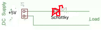

I am wondering if I can snip off the pnlv233 adapter from my panasonic cordless handset base and replace it with a USB plug that I could use anywhere (even traveling in Europe 220v)? The output on the adapter is 4.8v 0.16a and .768w.

it charges 2 AAA NiMH 1.2v batteries. I want to snip off the adapter that extra handset holder - all it does is recharges the 2 NIHM batteries - and put a USB at the end. Then plug that into a USB port on a European 220v to USB charger.

I know yours is not a VTech but this is basically what you want to do yes? or no? thank you.
If the answer is yes then I would put a Schottky diode in series with positive 5volts which would drop the voltage down approximately 0.3 volts giving you around 4.7 4.8 volts. If this is not done you run the risk of overcharging the batteries they will heat up it will not last as long as they were intended.

And the answer is yes!
I've done the same thing but with the Schottky diode although if you do not insert the diode you must remember not to keep it on the handset overnight just charge it until full and take it off the charger and that's a pain in that you know what!

Exactly which Schottky do I buy? and connect to the non load side?
Schottky Diode 1 amp, package style
DO-41 reference the datasheet please.
(K) stands for cathode (A )stands for Anode.
The white stripe on the DO-41 package is the cathode (K) . That white stripe should be orientated towards your cradle in series with the positive side of the USB connector. If you have any
other questions please ask.
Also... these are general purpose Schottky Diodes you don't necessarily have to buy from Mauser. shop around they should be less than $1 U.S.
