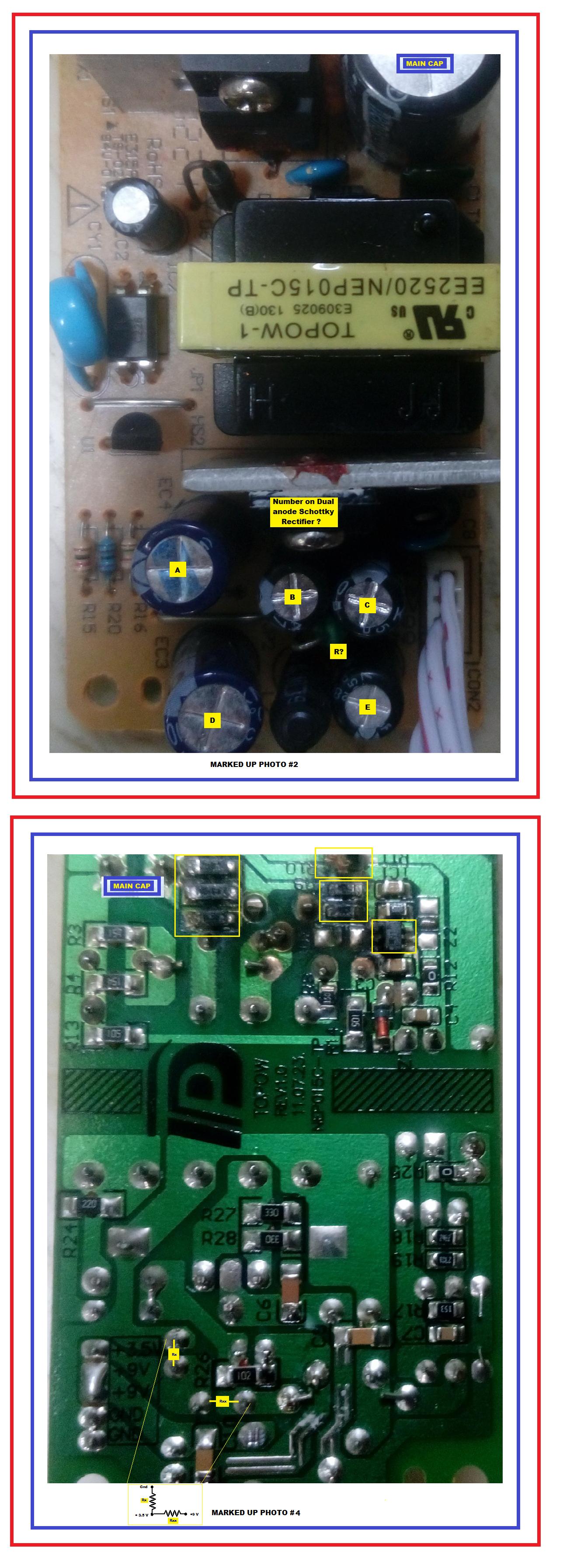

Hey guys,
I have a philips dock (dc291/37). It runs on 110V,60Hz supply. Ive been using it in India(220v,50Hz). Unfortunately, some of the SMD caps in the power circuit got burnt, rendering the dock useless now without a power supply circuit.
Since, there is no way to replace the burnt caps and resistors, I am thinking of making my own power circuit for this dock.
The board gives out (GND,9v and a 3.5V) output. Hence, All I want to do is to build a simple rectifier circuit which accepts 220V 50hz input , steps it down, rectifies it and regulates and delivers the required dc outputs.
The original circuit seems so complicated, so im skeptical about my attempt to repair this. I am attaching a pic of the original power board, do let me know if my approach is right and can be successful.
Pls excuse me for any silly doubts, ece undergrad here, trying to get hands on! Pls let me know if more details required!

If you are planning to use regulators to make the desired voltages at 7.5 watt then i think it will not be possible.
normal regulators like 7809 can deliver 1 amp maximum only with proper heatsink.

I don't think thats burned caps on the board. Looks like the regulator got really hot trying to step down all that extra voltage... Which may have cooked a couple of SMD parts. Which suggests the transformer is still good. I see a small transistor and an optocoupler that might have had a bad reaction to too many volts. Everything else on that board looks rated to handle the abuse.

For that 3.5 supply situation, you need to provide me a better photo of both top and bottom HALVES
of the PCB with the 5 pin output connector.
It is too dark to ascertain the manner in which the circuitry / components derived the voltage drop.
Take the pic outdoors . ..straight down . . . .squared in the viewfinder . . .using overhead sky lighting . . . .
with no sun shining on the board to make any shadows . . .in as close as possible to fill in the frame.

On photo # 2 down, you still get an F in your macro-photography expertise, but I believe that I can work with it when I look DEEP-DEEP down in that black hole.
I was figuring that the wall wart that I showed could be acquired for very little cost as a used unit that someone or some thrift store might have, veeeery-veeeeeery cheeeep !.
On my initial reference to batteries, I was considering we were in the mode of " being stranded on a desert island" with limited parts access available for working with..
Deeeep down in that black hole, on the next picture,I was just barely able to make out a green metal film resistors end poking up..
Check out my markup of your photo number #4 and see if the Rx and Rxx resistors seem to be in that position on your board then take an ohmmeter and measure their values. If their resistance ratio is being ~ 2.5 to 1 . .that is HOW the 3.5VDC supply is being acquired from the principal 9 VDC level..
Needed info below, to now be acquired and passed back for my evaluation:
Give the capacitance and voltage rating on the main cap to see how much overtaxed it was.
Normally one is expecting only 160-170 VDC to be hitting it, when properly used on 120VAC input .
See if the main power transistor beside that main cap is being of the MJE13004-5-6-7- family.
Give A B C D E electrolytic capacitors voltage and capacitance ratings.
The rectifier case above those caps that I marked, seems to NOT be a full wave bridge with its typical 4 terminals, but a 3 terminal dual diode.
Confirm its marked on numbering.
It will eventually be pulled out, to positively isolate the old power supply portion from the add on mod from any bleed thru..
OBSERVATIONS:
Photo 4 markups:
Made in YELLOW
The triad of surface mount resistors from the main power supply were inadequate in the initial voltage drop to the primary of the power transformer. The duo on the power transistors emitter were dissatisfied also.
The foils had a flashover .
Little surface mount IC was also not any too happy.
Mental note:
Revise power transformer marking from TOPOW-1 . . . .to KA-POWWWWWWW !
MARKED UP REVISIONS OF YOUR PHOTOS:

Hey Edd,
Here are the details of the components you asked for:
main cap : 22uf 400V
a : 1000uf 16v
b: 470uf 10V
c: 470uf 10v
d: 1000uf 16v
e: 1000uf 16v
f: 200uf 16v
R : 10 ohms(the metal film one)
one beside main cap: svf4n60f 600v n mosfet.
schottky rectifier - srf1045c
and btw, the rx seems to be a cap(the 'c' one) rather than a resistor and rxx is the metal film one(10 ohms)..
